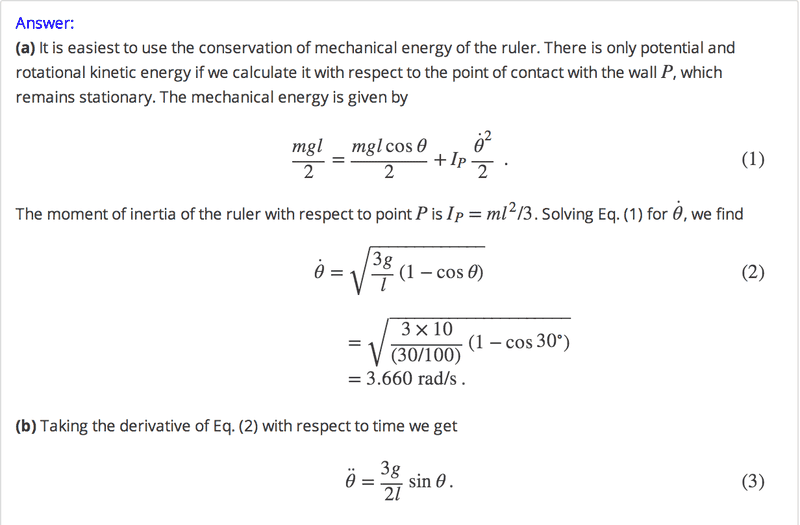

In reviewing my last physics exam I found the following statement in the posted solution:
...the derivative of [itex]\sqrt{\frac{3g}{l}(1-cos\theta)}[/itex] is [itex]\frac{3g}{2l}sin\theta[/itex]
N/A
This is from a physics course and I'm not taking the calc co-requisite yet so I'm trying to get by on what I can teach myself, which is inadequate for this task apparently. I don't understand the process of getting [itex]sin\theta[/itex] out of [itex](1-cos\theta)[/itex]

Well, I'm glad you do because I don't. This is simply not true:
The derivative of [itex]\frac{3g}{l}(1-cos\theta)[/itex] is [itex]\frac{3g}{l}sin\theta[/itex]
The derivative of [itex]\sqrt{\frac{3g}{l}(1-cos\theta)}[/itex] is [itex]\frac{3g}{2l}sin(\theta)\left(\frac{3g}{l}(1-cos(\theta))\right)^{-\frac 12} = \frac 12\sqrt{\frac{3g}l\left(1+\cos(\theta)\right)}= \sqrt{\frac{3g}{2l}}\cos(\frac \theta 2)[/itex]
But I would prefer to simplify first: [itex]\sqrt{\frac{3g}{l}(1-\cos\theta)} = \sqrt{\frac{6g}{l}}\sin(\frac \theta 2)[/itex]
So here is the source of my question. This is the solution to the physics problem posted by my physics professor at MIT. I probably just posed the question incorrectly, but since what I was really interested in was just "what is the derivative of (1-cos(theta))" I understand now what the answer is.
No, you posed it correctly. Equation (3) in your attachment is wrong.
Probably something got left out by accident, but without seeing the subsequent equations it's hard to know. E.g this would be correct: ##\dot \theta \ddot \theta = \frac{3g}{2l}\sin(\theta)##
