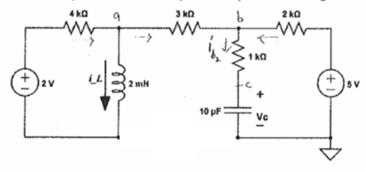

Derive the governing equation for the voltage Vc across the capacitor
KCL and KVL
I was thinking about doing KVL around the circuit at the right but I noticed when the switch opens, the current through the circuit at the right is not the same throughout
-5 + Ic*2*1-^3 + Ic*10^3 = -Vc
Ic is not the same around the right circuit so I am stuck....

Hi,
I suppose you did part a and you have ##V_c## and ##I_L## at ##t\uparrow\infty## ?
Care to explain this ? In particular the second term ?
I can't even read it " ##I_c * 2 * 1 - ?^3 ## "?
Do you mean ##I_{b_2} * 2\ k\Omega## ?
I also think you need some more relevant equations ...

Yeah, I meant KVL:
-5 + Ic*2*10^3 + Ic*10^3 = -Vc
I know what part a is. I am wondering about part b.
So the 1 and 2 ##k\Omega## resistors have the same current ?
And do you mean ##I_c = I_{b_2} ## ?

Backing up: do you have ##V_C## and ##I_L## for ##t<0## ?
And for ##t\uparrow\infty## ?
I only know Vc = 3 V; I_L =0.0015 A for t < 0
Agreed. Now, when the switch is opened, can there still be a current through the 3 ##k\Omega## ?
I think it can though...why can it not?

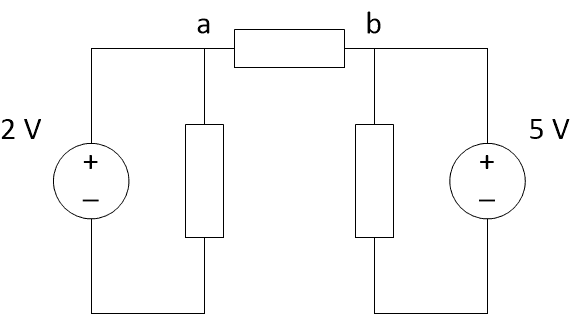

Like here
BvU said:
Like here
View attachment 325428 ?
Can you explain explicitly? I still believe there can be current from a to b...
There is no potential difference between a and b if the two circuits are not connected to the same ground.
[edit] or do KVL for each of the loops ....
A circuit is called a circuit because there is a return path that completes the circle.
Without the return path, there can be no current in R=3k.
The value of R=3k becomes irrelevant and may as well be a short circuit.
Nodes a and b will then have the same voltage.

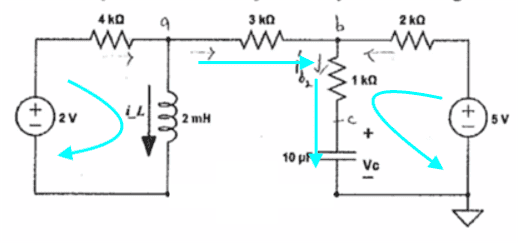

I don't understand. I drew the circle and currents in blue below:
Would you expect a light globe to work if you only connected one wire to the battery?

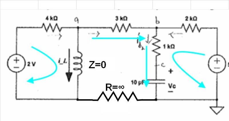

Another tack: what do you find for ##V_C## and ##I_L## for ##t>>0## ?
First, if the start process is finished the current through L will be d.c. that means ω=2*π*f=0 then the voltage drop through L will be 0.
On the capacitor eventually, after infinite time, the current will be 0 since Zcap=1/ ω/cap and if ω=0 Zcap=∞
Second, if sw1 is open that it is like instead sw1 a resistance of ∞ ohms is inserted here. So, in the loop between a and b the current it is total voltage drop [what ever it is] in the loop divided by ∞ [no current will flow here].
By-the-way, if between two points in a circuit the voltage drop is 0 then the potential V1=V2. The voltage drop =Z*I. If Z=0 or I=0 the voltage drop is 0.:smile:
It is not so complicate. You have to find Vc=-(5-Vo)*e^(-γ*t)+5 like formula where Vo it is Vc before sw1 opening.
