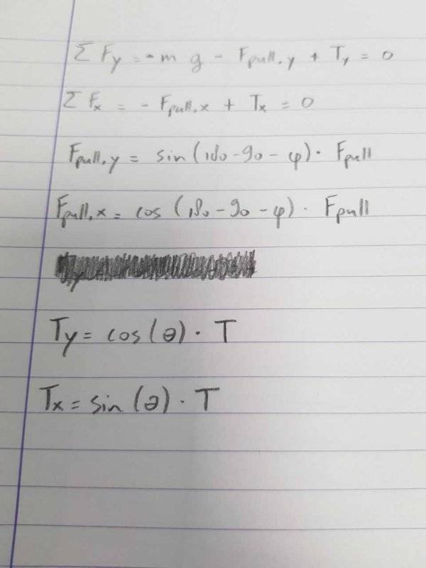

The problem with dissolving the forces is that the location of the pulley is unknown.
Now is the time to make a better drawing and decompose the tension forces. First for a steady state (=balance, load hangs still). You 'll need to introduce one or two angles. And perhaps make a simplification if allowed (like: drum far enough away)

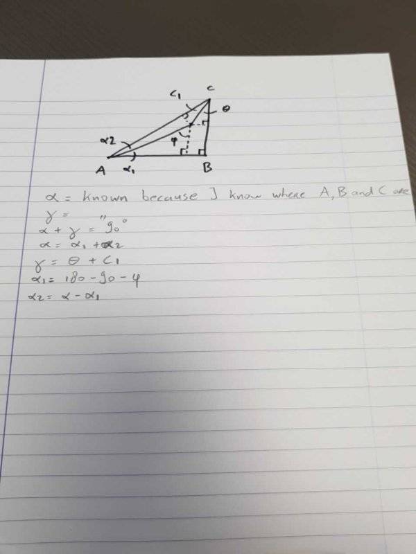

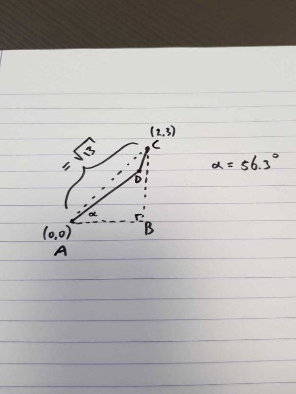

I don't fully understand. For example this is the situation with given parameters and CD has a length of 2.
alpha is the angle in ABC

That's a helpful diagram.
Let CD make angle θ to the vertical (angle BCD) and AD make angle φ to the vertical.
Can you get an equation relating , θ, α and the lengths AC, CD?
