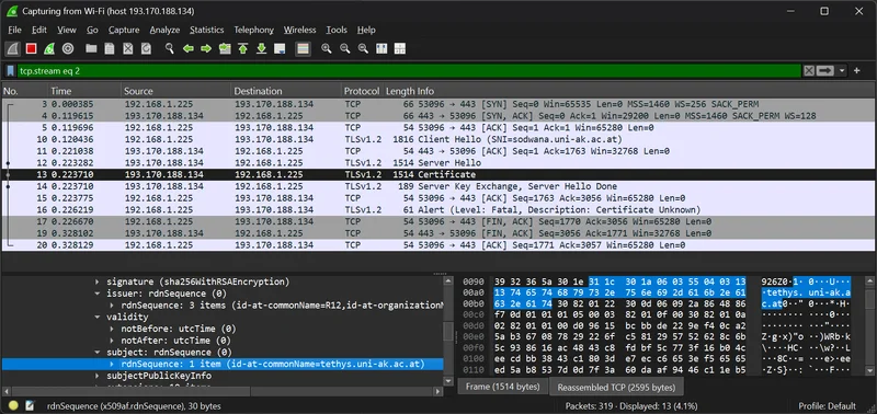

Theorem: There does not exist a smooth immersion of the hyperbolic plane into Euclidean 3 space.
... despite the above, it is possible to embed "patches" of hyperbolic plane into Euclidean 3 space.
.... one of the more well-known is the tractricoid.
Likes Jaime Rudas
  • #47
martinbn said:
There is a theorem, i think Hilbert, that says that a constant negative curvature surface cannot be embedded isometrically in three dimensional euclidean space.
Even though the hyperbolic plane can't be embedded isometrically in 3D Euclidean space, can it be isometrically embedded in three dimensional Minkowski space ?
  • #48
renormalize said:
Is this material available anywhere else? Regarding your link, my security software states:
"Your connection to this web page is not safe due to an unmatching security certificate."
My training as a network engineer (retired) has been activated...
On the face of it, the URL (http://sodwana.uni-ak.ac.at/geom/mitarbeiter/odehnal/talk/innsbruck_2014.pdf) is for plaintext HTTP. And indeed, a plaintext HTTP request does result in the PDF being retrieved.
Wireshark said:
GET /geom/mitarbeiter/odehnal/talk/innsbruck_2014.pdf HTTP/1.1
Host: sodwana.uni-ak.ac.at
Connection: keep-alive
Upgrade-Insecure-Requests: 1
User-Agent: Mozilla/5.0 (Windows NT 10.0; Win64; x64) AppleWebKit/537.36 (KHTML, like Gecko) Chrome/140.0.0.0 Safari/537.36
Accept: text/html,application/xhtml+xml,application/xml;q=0.9,image/avif,image/webp,image/apng,*/*;q=0.8,application/signed-exchange;v=b3;q=0.7
Accept-Encoding: gzip, deflate
Accept-Language: en-US,en;q=0.9
HTTP/1.1 200 OK
Server: nginx
Date: Sun, 21 Sep 2025 21:13:13 GMT
Content-Type: application/pdf
Content-Length: 1987963
Keep-Alive: timeout=20
Last-Modified: Tue, 28 May 2019 09:08:26 GMT
ETag: "1e557b-589ef01ec3680"
Accept-Ranges: bytes
%PDF-1.4
However, one can see that the browser is invited to upgrade the insecure HTTP connection on TCP port 80 to a secure connection on TCP port 443. And my browser (Chrome) is happy to attempt that.
The TLS connection begins with Chrome sending a TLS 1.2 Client Hello with a Server Name Indication of sodwana.uni-ak.ac.at.
Edit: Digging further, the subjectAltName extension is present with a dNSName of tethys.uni-ak.ac.at.
The URL: https://tethys.uni-ak.ac.at/geom/mitarbeiter/odehnal/talk/innsbruck_2014.pdf seems perfectly functional and checks out as secure.
My browser responds with a TLS 1.2 Alert: "Certificate Unknown" and closes the TLS connection.
However, since a copy of the PDF was successfully retrieved using HTTP, my browser was happy to present that.
Likes cianfa72, renormalize and nasu
