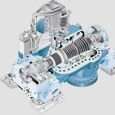

The only problem with that arrangement is that steam turbines use more than one set of blades to turn the energy of the expanding steam into rotary motion. You might blast the first row of blades in this manner, but what about the ones which are located in succeeding stages?
Here is a diagram of the arrangement of a typical steam turbine:
The moving blades alternate with the sets of fixed blades which serve to direct the flow of steam into the next set of moving blades. In a large turbine, there may be 20 or more sets of moving and stationary blades. What is not shown here is that all of these blades are surrounded by a casing which keeps the steam flowing in one direction:​
