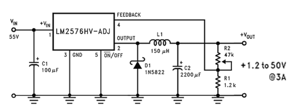

1. I am using the attached schematic as reference for my design. As per the LM2576 module data sheet, it can handle a maximum current of 3 A whereas I need the IC to handle at least 15 A. After digging around a little this was one buck converter that seems to be able to handle 15 A. However, the video says that this buck converter uses the IRFB3607 MOSFET. Does this mean that unlike the schematic above, in the case of the module in the video, the MOSFET that acts as a switch is a separate component from the controller IC? If so, what is the IC being used, what search parameters should I use to find such ICs?

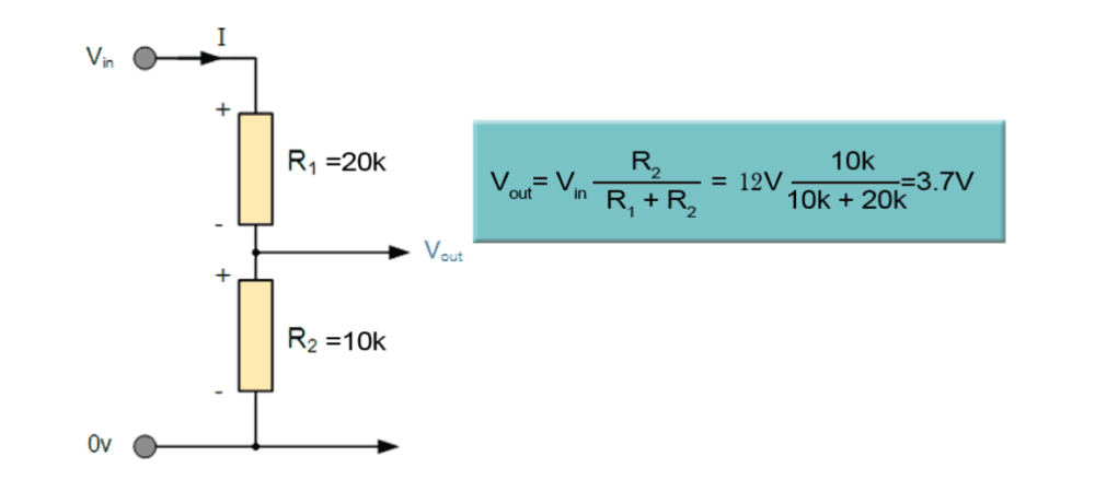

2. Coming to the regulated output voltage, my understanding is as follows... since I decide ##V_{in}##, if I want a specific ##V_{out}##, the equation above would give me the required ratio of resistances. Essentially, I need to have a potentiometer which must be manually adjusted to get the desired output voltage. If my understanding correct so far, why is the feedback wire NOT connected to the ##V_{out}## node in the first schematic? Or is it that there is a mistake in the first schematic and the point between ##R_1## and ## R_2## is the actual ##V_{out}##? In fact, I am unable to pin down the exact role of the feedback pin. Under what circumstances would the output voltage fluctuate (would it fluctuate if the load were to suddenly draw more current or if its resistance changed for some reason)?

2. Coming to the regulated output voltage, my understanding is as follows... since I decide , if I want a specific , the equation above would give me the required ratio of resistances.
No, it's not that way. The feedback pin has an IC specific input voltage threshold: if the signal there is lower then the chip will try to push out more voltage: if the signal is higher, it will fall back.
Since the feedback pin has a specific threshold, you divide the output voltage so to have that threshold at the required output voltage. If the output voltage falls short, the feedback gets lower and the IC will push harder.
So the schematics is correct.
Since the IC works based on the output voltage only, the input voltage can vary within a certain range without affecting the output voltage.
