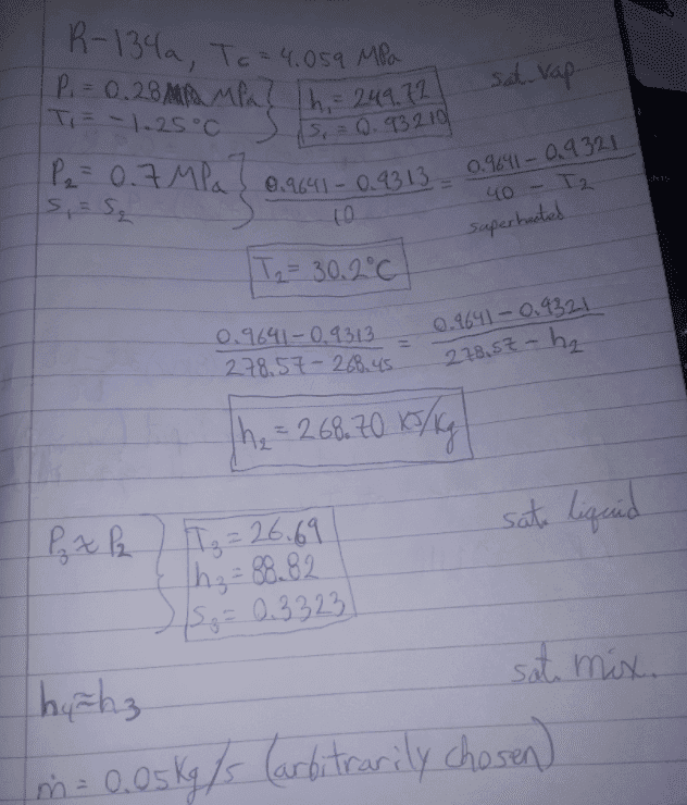

I'm a recent ME grad and I'm trying to design a refrigeration system for the first time. I understand most of the theory and calculations (I guess not, cause I wouldn't be here otherwise), but I'm having difficulty applying it to the real world. Homework problems in college often prescribe initial conditions, however, in the real world we have to determine what those conditions are before starting the problem! College never explicitly shows us how to do these things...
Anyway, after solving a problem I created with conditions I thought made sense based on research, I've decided that it might be easier if I just selected an arbitrary compressor for my calculations and see what happens. Here is the compressor I'm looking at: https://www.grainger.com/product/EMBRACO-Refrigeration-Compressor-5AHA1
At the moment, I'm mostly confused about the "Evaporating Temp" and the "Condensing Temp" listed on their webpage. Is it a limitation of the compressor? Recommendation? It doesn't even state a pressure to go with those numbers...
In my latest analysis, I have 29.75 F @ 0.28MPa going through the evaporator and into the compressor inlet. At the compressor outlet, assuming isentropic compression, I have 106.16 F @ 0.7MPa. (I converted celsius to fahrenheit in this post to be consistent with the units reported by Grainger)
A Little Bit About The Values I Calculated:
I began constructing my analysis at the Compressor Inlet as State 1 of the Vapor-Compression Refrigeration Cycle. I know that, to avoid air leaking into the system, the pressure in the system must be greater than 1 atm at all times; therefore, I arbitrarily chose a starting pressure of 0.28MPa due to ignorance of possibilities. I expect to lower this pressure to a more realistic value as I learn more through the design process. Naturally, assuming an ideal system without superheating, the temperature at State 1 is taken at the saturation temperature of R-134a vapor.
The pressure at State 2 was chosen as 0.7MPa. I did light research to conclude that the hottest temperature of my currently location throughout the year is 30 C. So I chose 0.7 MPa because it was the lowest convenient pressure in the superheated charts that provided a temperature above 30 C with the same entropy of State 1, which will enable heat rejection to environment at the condenser. (Specifically, 41.2 C / 106.16 F)
Using an expansion valve, the enthalpy is assumed to be constant as the pressure drops from the condenser exit to the evaporator inlet. No subcooling.
Of course, the pressures chosen don't take into account whether a compressor exists in the market that can actually perform the task specified, this was just a dry run to get my feet wet. If I have done this correctly, the work input for this hypothetical situation is 0.9 kW / 1.2 HP with a COPr of 8.9. (Assuming an arbitrarily chosen mass flow rate of 0.05 kg/s) The ideal COPr,carnot calculated was 9, using TL = 10 C and TH = 30 C. The fact that the COPr is so close to ideal indicates I'm very skeptical of results. Haha...
With that said, I used exergy to determine the theoretical minimum power input required to remove heat at calculated rate and reject it to the environment at To = TH. The value I got was 16 kW / 21 HP, which is considerably higher than the 1.2 HP quoted earlier. Very confusing.

Hi, welcome to PF!
I'm not completely sure what you are after here, but you may be jumping ahead of yourself. You've attempted to design the cycle for an air conditioner based on local weather, but without connection to a real-world problem/requirement. And your process doesn't really match how real-world HVAC engineering is done. You've basically just done a modified homework problem. So let me discuss how some real-world HVAC engineering is done and see if that's what you're after.

For R134a as a saturated mixture going through the evaporator at 45 F, the pressure is 54.787 psia.
For R134a as a saturated mixture going through the condenser at 130 F, the pressure is 213.53 psia.

Well, I chose the compressor arbitrarily. It's not based on any qualifying metrics. I'm just confused that they're specifying an evaporating and condensing temperature.

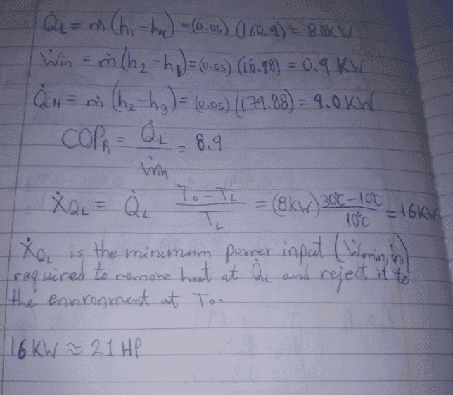

How exactly did you calculate that? Also, I don't see where you calculated or specified a required cooling capacity?
In my textbook, Cengel 7E pg. 621, it defines the minimum power input (Xq) required to remove heat at a rate Q from a low temperature medium at TL and reject it to an environment at temperature T0. The equation goes as follows:
Xq = Q * (T0 - TL)/TL
Instead of a cooling capacity (which may have been a mistake), I chose the temperature of the cooled environment that I wanted. In this case, 10 C. In other words, I wanted the heat absorption rate of refrigerant at -1.25 C in the evaporator to produce 10 C wind as a fan blows over the evaporator and into the air conditioned room.

I'm still not following. You have T0 = 10C and TL = -1.25C. (10- -1.25)/(-1.25+273) = 0.04. What is Q?
That equation is the inverse of COP, times Q. COP is the ratio of work into heat transfer, and you're looking for work in. It's pretty obvious that your work in should be a small fraction of heat transfer.
Also, in the prior calculation, I'm getting a 14 COP, not a 9 COP. But without seeing your actual math, I can't be sure what you're doing or if I'm really duplicating it.

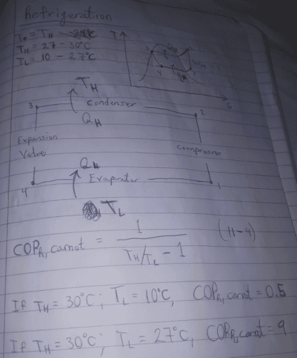

Sorry, I wasn't clear. T1 = -1.25C is the temperature of R134a saturated vapor at the compressor inlet. Which was determined after arbitrarily choosing an inlet pressure of P1 = 0.28MPa.
TL = 10C is the target temperature of the refrigerated room, it's the temperature of the medium where heat is absorbed at the evaporator.
TH = 30C is the maximum/highest temperature of the outside environment from where I currently reside (according to a light google search).
Using TL and TH to calculate the COP of a reverse carnot cycle yields 0.5
If I use TH = 27C as the lowest environment temperature throughout the year, I get 9
In image 1, please ignore the T-s curve in the top corner. I originally wanted to implement superheating in my calculations, but opted for keeping it simple to make sure I'm doing everything properly. At the bottom of the page, you can see equation (11-4) which is the reversed carnot COP and the values yielded as I described above.
Image 2 shows my process and how I arrived to my values. The mass flow rate indicated at the bottom was taken from a homework problem. I figured I could just replace it once I figured out how to get an actual number.
In Image 3 I used the equation for calculating the COP of refrigeration cycles, which as you stated, is the ratio between the heat removed from the refrigerated environment and the power input. I then used the exergy equation at the bottom which, as you have noticed, is the rate of heat removal divided by the reversed carnot COP. I used google to convert kW to HP.
