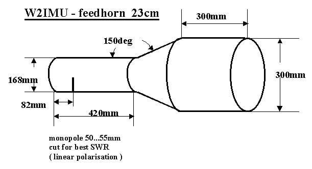

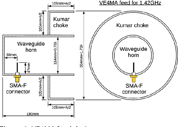

There are two types of feedhorn that I found so far that should work fine. First, feedhorn with Kumar choke, good for dishes with f/D around 0.3-0.4
and W2IMU dual mode feedhorn that is good for f/D around 0.5-0.7
Right now I'm leaning towards W2IMU feed and f/D=0.5 but without an objective reasons. f/D=0.5 because it looks the sturdiest for me personally - larger f/D have focal point very far away and there will probably be some movement and problems with feedhorn going out of focal point.
W2IMU feedhorn because it's smaller than the other one, I already read much more about it and looks to be easier to make.2) Mainly to learn. For a very long time I though radio astronomy is awesome and I want to try it, and learn as much as I can on the way. If it does work, great, if it doesn't I would at least gain some knowledge.

The problem is that there really isn't a good guide on how to design feedhorns. Yes, I can simulate them in NEC program, but it such a pain, you need to make a fine mesh in the shape of feedhorn. I'll do it one day, but not right now.
This link will give you some ideas about DIY feeds. Very cheap and cheerful but, bear in mind that the results from small, low gain dishes seem to be more to show that you can do it than to get fab results. My point is that you are likely to want to move on up (as with all other Astronomy activity) and buying / making bigger and better. These guys have produced a list of useful information sources.
Thanks, but can antennas have pretty low efficiency. What I'm looking at now (VE4MA and W2IMU feedhorns) are advanced versions of it. I know, I'm probably complicating things too much. I should try first with can antenna, but I really want to start with best feedhorn that I can.
All the design agony you are going through will only make a small difference to gain, in the order of 1dB. You can lose that in the connecting cable. A small difference in diameter will compensate for efficiency variations.
