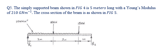

Determine the position and magnitude of the max bending moment
The discussion focuses on determining the position and magnitude of the maximum bending moment in a simply supported structure under varying loads, including a cat and snow. The user initially calculated the reactions and bending moments but encountered inconsistencies, particularly with the uniform distributed load (UDL) from the snow. It was clarified that the UDL should be treated as 110 N/m, and the total load should include both the cat and the snow, leading to a combined load of 99.2 N. The user also faced challenges with Macaulay's method, struggling to correctly apply it due to misunderstandings about including negative values in calculations. The conversation emphasizes the importance of accurate unit conversions and the correct application of load distribution principles in structural analysis.
Al_Pa_Cone
143

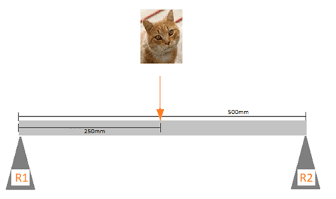

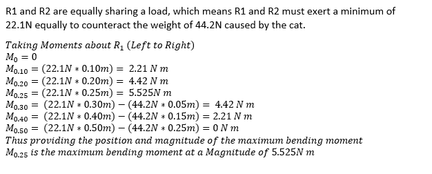

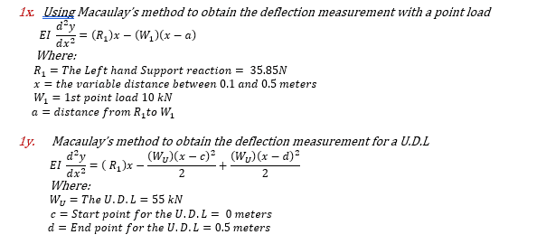

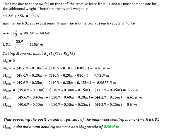

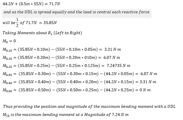

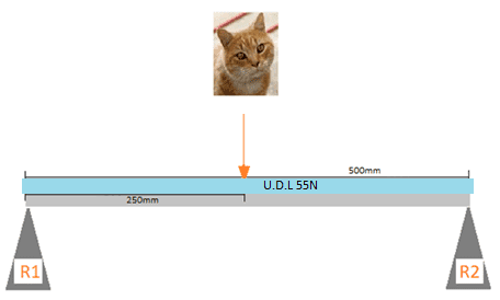

For my question, I am following a previous method I used in my HNC where I had to determine the position and magnitude of the maximum bending moment. I am now working on my project and I have revisited this question but I am having some issues in my method. The above diagram is of a simply supported structure with the weight of an average cat in the centre. The structure is 500mm wide and simply supported at either end as shown.
The cat weighs 4.5kg which translates to a force of 44.2N and as it is stood in the centre of the structure (250mm), R1 and R2 must react with 22.1N to maintain the structure.
Therefore my first answer is below in FIG 1.Next I introduced Snow to the structure giving s uniform distributed load across.
I worked out that, typically snow weighs between 70kg and 150kg per cubic meter. I have a surface area of 500mm x 500mm with a possible depth of 150mm snow on the structure. Therefore, the cubic area would be

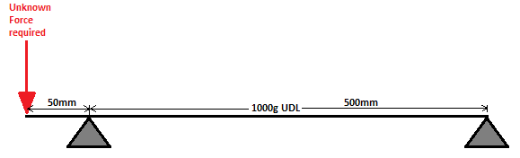

Which leads me to my next diagram as shown below.
This time due to the snow fall on the roof, the reactive force from R1 and R2 must compensate for the additional weight. This method is shown in FIG 2.
I cannot see how the maximum bending moment in both situations much less than the force from the cat alone. I have tried this several ways and ended up with different answers each time. I believe my error is in the units of measurment as I am showing my answer in N m and the structure is only 500mm or 0.5m wide. Should I show my answer in N mm? am I making another error somewhere along the way?
All my methods are below.
FIG 1.
FIG 2.

I would convert the uniformly distributed load to a single equivalent concentrated load.
The total snow load on the full width and length of the beam is 55 N. Since the beam is 0.5 m in length, that load is distributed at 55/0.5 or 110 N/m. You can use the 55N total load as a concentrated load at the cg of the distributed load to calculate end reactions, but when determining internal bending moments along the beam, you must use the distributed 110 N/m load.
You should prove to yourself that the max moment in a simply supported beam with a concentrated load P at the center occurs at the midpoint of the beam length and is equal to PL/4, whereas the max moment in a simply supported beam with a uniformly distributed load P/L occurs at the midpoint of the beam length and is equal to PL/8, that is, the max moment is halved when you distribute a load over the beam length versus concentrating it at a single point in the center.

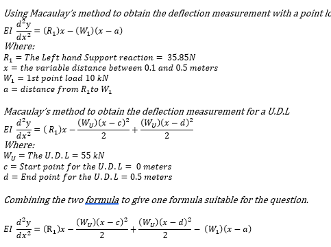

I understand it would be easier to define the UDL as a single point concentrated load however the reason I am working it out in the way I am is due to the next step, which I have not yest posted. This is confirming my calculations using macaulays method. A method I previously used on an assignment which I also seem to be getting an unusual result. I need to know if my calculations are correct to understand what I am doing wrong in the following method

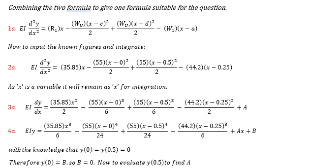

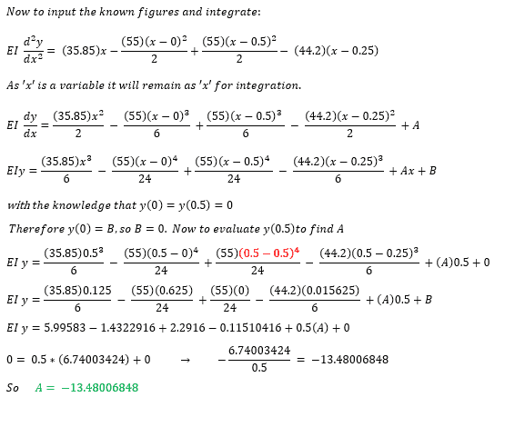

I will post my results for Macaulays method to show you what I mean..

I haven'tooked at Macaulay, but for starters, the uniform distributive load is 110 N/m, per post #3.
Reference https://www.physicsforums.com/threa...d-magnitude-of-the-max-bending-moment.956272/
Thanks, I will update my calculations with that information. I remember doing that early on in my lessons now but it has been a while since I have needed to use it.

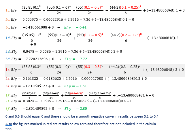

I think there is another error somewhere in my method. If my original method for obtaining the bending moment is correct ( apart from the actual value of the UDL) then there is something wrong in my work using macaulays method.
Perhaps you have already corrected this, but your first eqn in Fig 2 is wrong. You have already calculated the total snow load as 55N. It makes no sense to multiply that by the beam length. Indeed, it would have the wrong dimensions.
However, what you posted in Fig 2 is at least consistent in, effectively, using 55N/m as the distributed load, so there must be another error to get a lower answer than with the cat alone.
Check your arithmetic for 0.54.
The trouble with posting your work as images is that it makes it hard to comment on specific steps. Please number your equations.

Where did the 10 kN point load come from if the cat weighs just 44.2 N? And why are you even looking at Macaulay? The point of max moment occurs at the point of 0 shear. Are you familiar with shear and moment diagrams? Once you know the point of max moment, just sum moments about that point in a free body diagram of the section of beam cut at that point. And if you don’t use the distributed load as 110 N/m, you will never arrive at the correct answer.

You have failed to incorporate corrections to errors that have already been pointed out. The total load is 44.2+55=99.2N, or 49.6N per support, not 35.85.
The distributed load is 55N/0.5m=110N/m.

Good Spot on that one, that was me being sloppy as I have used this method before and I have tried to follow the same method to suit my project. I will rework everything now and repost my answers.

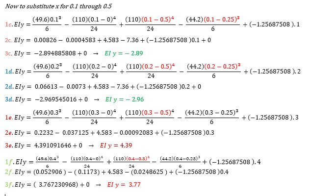

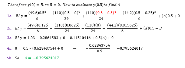

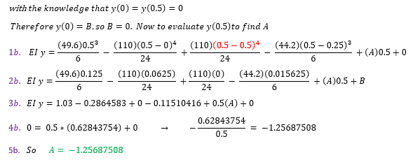

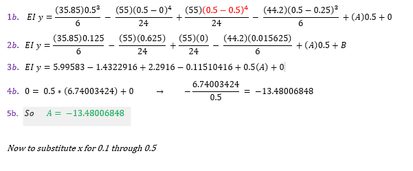

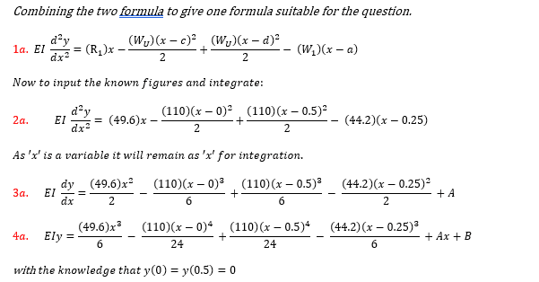

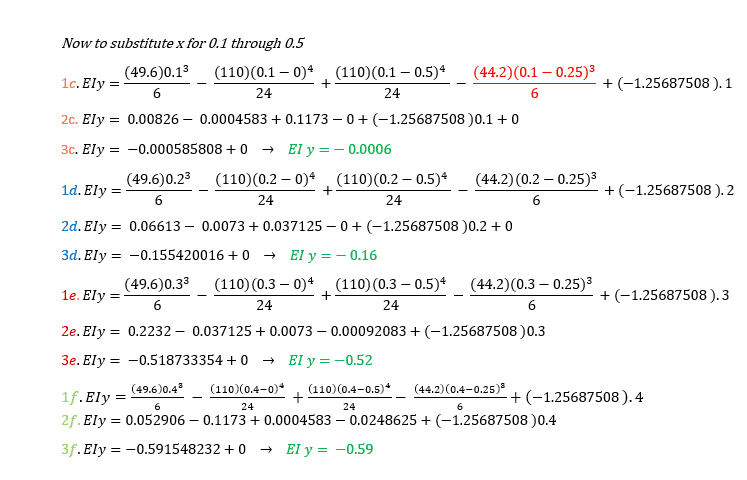

I am not entirely certain I am following the correct method but where the brackets are highlighted in red, it indidicates the value of the sum within is a negative value and shouldn't be included in the following sum. therefore I have been following this method until I inevitably get to my answer in 1e, where I must include (0.3-0.25)^3 in the sum and this is throwing my answer way off. Obviously I am doing something wrong?
I am not following line 4b. I get A more like -1.2.
Where does the 4.583 come from in 2e?
I don't know how I managed to get -0.79 on my first calculation
I have corrected that to be -1.25 and as that is the value of A it transfers throughout the rest of the method so I have reworked it. I get 4.583 from 2e from 110/24 as I am not including the (0.3-0.25)^4 because the answer is a negative value. There is still something wrong which I can't put my finger on? The values should plot a nice negative curve on a graph.

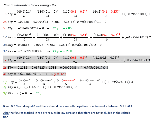

Not following.
You correctly exclude the 0.3-0.5 term (I don't see a 0.3-0.25 term). The term in 1e with 110/24 in it also has a factor 0.34. This whole term you correctly evaluate as the 0.037... in 2e. There is no other term with 110/24 in it.
haruspex said:
Not following.
the 0.3-0.25 term is highlighted in orange, I include this because the value was not a negative, therefore I think it should be included?
For your comment 'there is no other term with 110/24 in it.' I have highlighted my value in blue, I didnt include the (0.3-0.5)^4 therefore I was left with 110/24 giving the 4.583. I don't remember following any other unique method than, not including the negative values so I cannot put my finger on the problem
Thanks for your help with this one, I really appreciate your time.
Not including a term with a negative factor means setting it to zero. You are effectively setting the factor to 1.
Im sorry I don't think I am following, I can still include the 110 as it is not part of the method to eliminate anything in the nominator if one value is a negative?
If the ()^4 is raised to a factor and effectively becomes zero e.i (negative value)^4 and zero^1 is still zero, I am only left with 110/24 = 4.583 or I could exclude the whole term and set the value to 1/24 to arrive at 0.0416?
You seem to misunderstand an essential part of the method.
If you have a term like ##\frac{(load factor)(a-b)^n}{n!}## and a<b then you must throw away the whole term. It becomes zero, not ##\frac{(load factor)}{n!}##

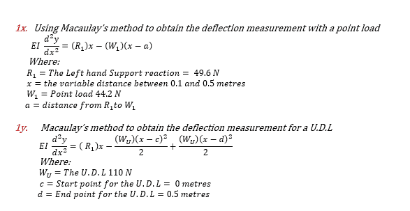

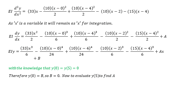

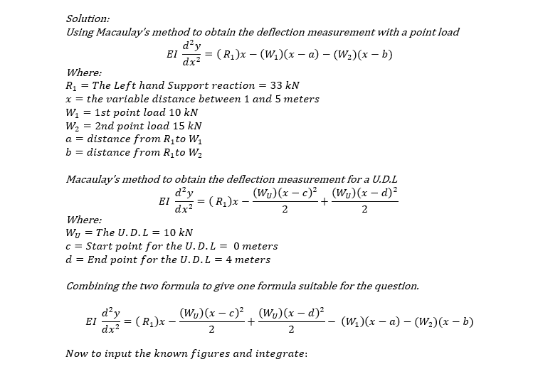

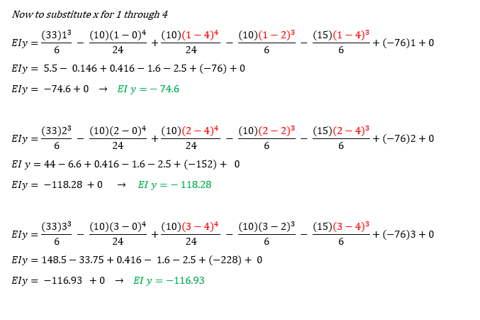

I have attempted to rework the method following your advice and in the first instance at step 2d, I get a positive value in the results of 0.3102. I thought there was still something I am missunderstanding so I attempted it again, this time excluding the term if the entire term was negative (not just the term within the brackets). Following this I get a set of all negative results however, they do not form a smooth curve as I would have expected when plotting in a graph. I have posted this method example below.

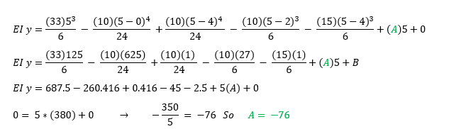

Below is an example of how we got through this problem the first time round and successfully produced a graph to match the situation. I have posted it as a reference to find out what is going on in this situation.

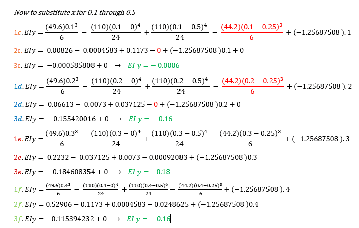

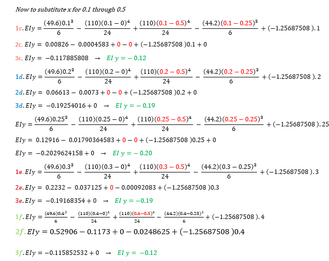

No, no. It is only the sign of the displacement that determines whether to include it.
The principle is this: at any point along the beam all of the torques and forces on one side exert a net torque about that point, and this is balanced by the net torque from the other side. It is the magnitude of these two opposing torques that determines the curvature at the point. So to find that curvature, you add up all the torques from one side only.
Forces on one side will have a positive displacement from the point, while forces on the other will have a negative displacement. So that determines whether to include it in the sum: only include those with positive displacement. The force itself may be up or down, so the term as a whole may be positive or negative.
Some authors use a special notation for this. E.g. you could put angle brackets <> around displacements. The interpretation is <x>=max{x, 0}, i.e. if x is negative substitute zero.
Are you saying that is wrong?
Please post your updated working.

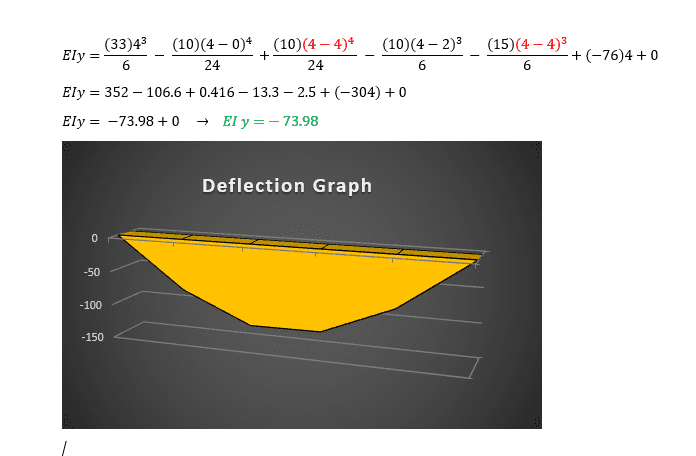

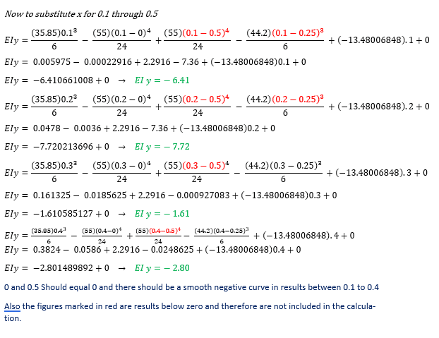

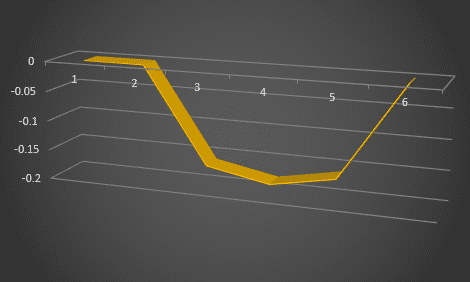

I somehow miscalculated step 2e and step 2f leading me to think I had unusual results. These results look good, and are what I was expecting. Does this look ok to you? I have been sloppy with my calculations all the way through. If I have learned something from this, it is to check my calculations more than twice if I still don't have the correct answer.

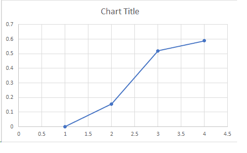

I wonder why there is a delay from 0 to 0.1 before the natural curve begins to take place? is there still something wrong with my method?

Al_Pa_Cone said:
I somehow miscalculated step 2e and step 2f leading me to think I had unusual results. These results look good, and are what I was expecting. Does this look ok to you? I have been sloppy with my calculations all the way through. If I have learned something from this, it is to check my calculations more than twice if I still don't have the correct answer.View attachment 233543
Reread my post #23 and have another go at line 2c. If the (a-b) is negative you must throw away the whole term. It is not a question of whether (a-b)n is negative.
This is what I expected to find! Thank you so much for taking the time to help me again... The world needs more people like yourself!
