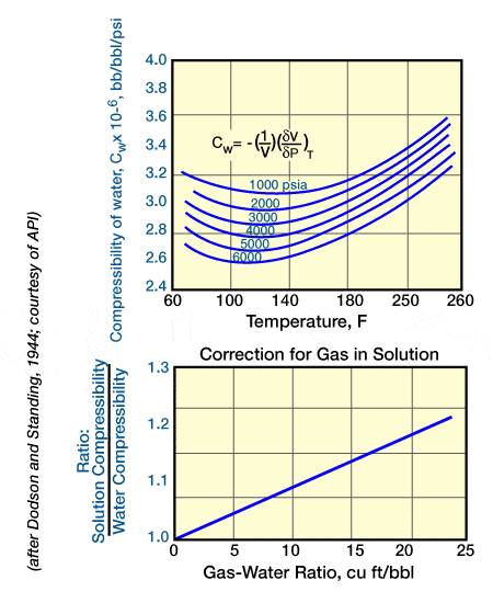

The only extra info you need is how much volume changes as pressure changes in the vessel. The volume goes up due to the elastic nature of the vessel. It is like a balloon that does not get much bigger as you inflate it because it is really strong. But it does get a little bigger at high pressures. How much bigger (and at what pressures) is what you need to know. And then it becomes a simple problem. The valve at X position and P' pressure passes V volume/time which changes pressure by P/time. Rinse and repeat as pressure changes.

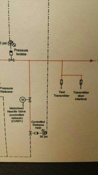

Unfortunately, I haven't been on site yet. But I do have a P&ID. I'll upload the part of the P&ID that we're interested in as the test pressure is isolated from the source.
Also, I'm not sure how much of the P&ID I can show before I break the confidentiality agreement!
The pressure to the left of the isolation valve is 0psi at this point. The pressure after the control valve is going to drain, so that's 0psi also. I don't know what the HP outlet looks like, but that goes to the valve that we're testing.
The test transmitter is the pressure sensor.
It's all filled with water as it's a hydrostatic test. Tests can be anywhere between 50-23000psi.

Sorry. I'm not too good at reading upside down.
Chet
Chet
Apologies! Here you go!

You can't find the pressure drop across the valve unless you know the flow rate. So if you are changing the valve position, which changes both the pressure drop and flow rate, you need to know the characteristics of the entire system to find what the new pressure will be at the next increment of valve position.
  • #32
I already know the pressure drop and the flow coefficient, from that I can determine the flow rate, but these are just instantaneous values. I want to know what the pressure drop will be after 1 second while I'm changing the valve position, which changes the flow coefficient. If I can determine that from the flow rate, how would I calculate what the flow rate will be in 1 second? I'm assuming I'll need the volume of the system...
It doesn't even have to be too exact, just a clue as to what a good position to put the valve in would be good. Then I can implement a control system based off that if I need to.
At the moment I am essentially completely blind as to how to implement this.
  • #33
Like I told you, you won't find any analytical solution. You need to implement a predictor corrector algorithm, where based on the change in flow rate in the recent past, you estimate the derivative, then adjust the valve, re-measure the flow rate and correct. Repeat until you achieve steady state.
If you haven't taken a numerical methods class, you might be in trouble...
But from your posts, I gather what you are trying to do is use existing data to pre-calculate what the valve will be at steady state, rather than do a real time computation. Simply put, you won't be able to do this. Yes, theoretically there might be an exact solution to your problem, but practically the effort expended in looking for this solution will not yield a good return on your investment... unless you happen to solve the N-S equations, in which case you'll become a millionaire and world famous and won't have to work ever again.
The steady state valve curves will give you an approximate starting point. You will have to compute the derivative of the pressure drop in real time and estimate. This is the best solution I can think of.
  • #34
Or... what you could do is open the valve, wait 10-20 seconds for steady state to be achieved, then readjust, repeat, etc. This method is not very elegant and is very slow, but it will work too.
  • #35
Are you trying to control the pressure drop at constant flow rate, the flow rate at constant pressure drop, or a combination of the two? If you're trying to control a combination of the two, then you need to quantify the interaction of the valve with the process equipment upstream of the valve (in terms of the fluid mechanics interactions). So far, aside from the control equipment, you haven't told us anything about the process equipment upstream.
Chet
