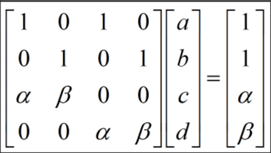

For a 2 x 2 matrix ##A## representing a Markov transitional probability, we can compute the stationary vector ##x## from the relation $$Ax=x$$
But can we compute ##A## of the 2x2 matrix if we know the stationary vector ##x##?
The matrix has 4 unknowns we should have 4 equations;
so for a ##A = \begin{bmatrix}
a & b \\
c & d
\end{bmatrix}## , we got
\begin{bmatrix}
a & b \\
c & d
\end{bmatrix}
\begin{bmatrix}
\alpha\\
\beta
\end{bmatrix}=
\begin{bmatrix}
\alpha\\
\beta
\end{bmatrix}
The system of 4 equations;
$$\alpha a+\beta b=\alpha, \alpha c +\beta d=\beta, a+c=1, b+d=1 $$
Given that ##\alpha## and ##\beta## are known.

It is not a solvable problem. I converted the problem of solving the matrix into a problem of solving a (4x1) vector.
The 4x4 matrix is not invertible, so there is no solution for the vector containing the entries of my original matrix.
However, the correct solution is
0.4 & 0.5 \\
0.6 & 0.5
\end{bmatrix}##
So, how to derive the solution?

Yes, just start doing it, the solution (or rather the infinity of solutions) is simple.
If you let ## a ## be a parameter you can immediately write expressions for ## b ## and ## c ## and then ## d ##
How can you believe this is correct when you already know that the identity matrix is a solution?
Likes PeroK
