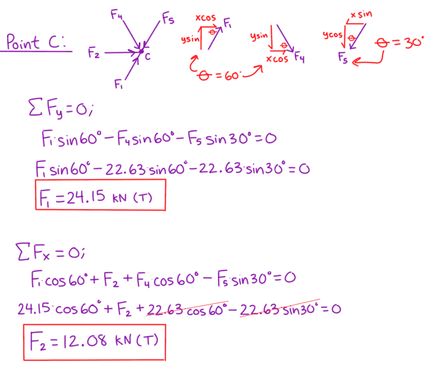

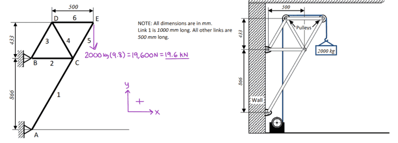

I am struggling to figure out if I did this problem correctly. I am supposed to determine the forces acting on all of the links, as well as whether they are in tension or compression. There is an image included below.
∑Fx=0
∑Fy=0
∑M=0

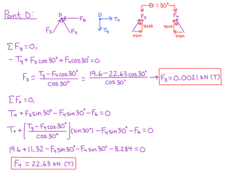

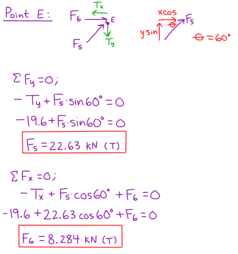

So far I have used methods of joints to determine the forces at point E, D, and C. However, there is also a pulley attached to point D and E which I included in the sum of forces, but I'm not sure if that's the correct way to apply them. Every force I've calculated so far has also been in tension, which does not seem right. I'm also unsure of how to calculate the reactions at A and B with the pulley involved. Any help would be much appreciated.

I would treat both pulleys as one.
The tension in the cable is the same everywhere.
Are those 2000 kg-mass or kg-force?
That weight is your tension, pushing D and E down and compressing link 6 from both ends.
Please, see:
https://www.ecourses.ou.edu/cgi-bin/ebook.cgi?topic=st&chap_sec=03.2&page=case_sol
Links 4 and 5 must be in compression, transferring that load down to node C, link 1 and pivot A.
Link 1 must be in compression, while ling 2 is pulling hard from pivot B.
Link 3 is not doing much, at least in theory.

It is 2000 kg-mass, yes. How would I go about treating the pulley as one? Since it's the same cable going through D and E, do I not need to apply it to the links multiple times?
Doing a FBD for each pulley, you will see that two compression forces go down the two links that meet at each.
Treat the cable as in equilibrium (Tin = Tout)

Triangle CDE is loading node C with (19.6 x 2) kN (straight down).
Calculating moments about pivots A, and then B, you can determine how much vertical and horizontal forces each is loaded with.
Only then, you will be able to visualize how each link is working.
