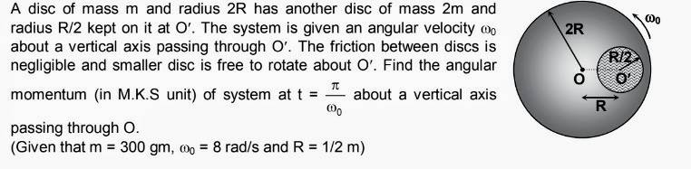

The problem diagram is as given below.
A small disk with center ##O^{'}## is kept on a larger disk with center ##O## as shown in diagram.
The system is given an angular velocity ##\omega_ {0}## about a vertical axis passing through O'. The friction between disks is negligible and smaller disk is free to rotate about O'. Find the angular momentum of system at ##t = \frac {\pi } {\omega_0}## about a vertical axis passing through O.

The setup is unclear to me. Are the disks allowed to move freely in the plane (apart from being linked)? Is the large disk fixed to O? If so how does the system rotate about O’ initially? Etc

The question is not making sense to me either. Is the system floating in space or mounted on a fixed axle at O or O'? Is it saying that each disk is given angular velocity ##\omega_0## about O'?
Please check that you have posted the whole question verbatim.

The question was confusing me too. The actual question in printed form is as below.
Since there is no friction involved so we can say that there is no torque on any disk except the torque that was initially applied to achieve initial angular velocity. In absence of any torque the rotation about O' continues at ##\omega_{o}## angular velocity.

The question in printed form is as given in my recent post#7. It's confusing me too. I guessed that the entire system is given an angular velocity about O'. So, it's like the bigger and smaller disk rotating about O' together. As far as how they are mounted is not given in the problem statement which you can see in post#7.

Out of curiosity I located the original question. It is Q13 here:
https://www.fiitjeenorthwest.com/admin/upload/AITS-1819-OT-JEEA-PAPER-2_3-2-19.pdf
The question appears (as already noted by others) to be ill-posed, making it (IMO) unanswerable.

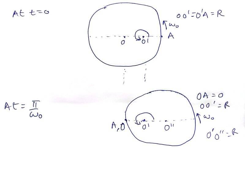

Is it possible that the small disk also rotates about O' with the same angular velocity as the larger disk ##\omega_{o}##? If small and large disks are somehow attached at O', then perhaps this could happen.

If both disks are mounted on a fixed axle at O' then there is no interaction between them. All gets rather boring.
Likewise if the larger disk is on a fixed axle at O.

The problem statement says that small disk is free to rotate about O', so it must be attached to some axle. Now, if this axle is given a certain angular velocity then the disks connected to these axles must also rotate with the angular velocity of axle about O'.
vcsharp2003 said:
The problem statement says that small disk is free to rotate, so it must be attached to some axle. Now, if this axle is given a certain angular velocity then the disks connected to these axles must also rotate with the angular velocity of axle about O'.
Oh yes, it is definitely mounted on an axle on the larger disk. The question is whether the system as a whole is floating in space or mounted on an externally fixed axle, and if so, where?
Odd that we are told the initial rotation is about a vertical axis, but not whether the disks are in a horizontal or vertical plane. The only clue we have is the curved arrow in the diagram.

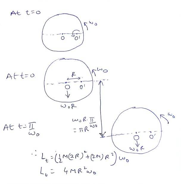

If I focus only on the larger disk then following are the positions at ##t=0## and ##t=\frac {\pi}{\omega_{o}}## as it rotates about O' at an angular speed of ##{\omega_{o}}##. We want to find the angular momentum about an axis passing through O and perpendicular to the plane of paper, of the larger disk at ##t=\frac {\pi}{\omega_{o}}##.
Are the two positions I have shown correct?
If yes, then would it be correct to say that angular momentum about O axis is moment of inertia of disk about O axis X angular speed about O axis at given instant?

You do not seem to have understood my post #27.
If there is no fixed axle at O' then the large disk cannot continue to rotate about it, with or without the smaller disk. There is nothing to provide the centripetal force.
Leaving out the smaller disk, we can think of the larger disk's initial motion as the sum of a rotation rate ##\omega_0## about its own centre and a linear velocity ##R\omega_0## in the negative y direction. And with no external forces, that is how it would continue.
Now adding in the smaller disk, we would need a centripetal force on that to keep the large disk rotating about its own centre, so something else must happen.
Any rotation the smaller disk has on its own axis is irrelevant since the centripetal force for that would be internal, so it seems to me we can treat the smaller disk as a point mass.

  • #35
haruspex said:
It is always valid to represent a motion as a sum of motions, and it often helps to represent a rotation about a point other than the CoM as a rotation about the CoM plus a linear motion of the CoM.
Ok, that's a very powerful truth. I was used to thinking in these terms only for a rolling object with no slippage on a horizontal surface since that's the scenario textbooks normally explain.
