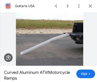

You might consider using two skinny ramps instead of a full-width one. That way you can have the ramps extend up a bit after entering the shed to help with clearance and then you just drop a couple inches off the end of the ramps once inside the shed.
Kind of like shorter versions of this ramp, with some 2x4 spacers under the right end to add the extra clearance height:

In case you decide to make it/them on your own, I'll share my old design.
I built a very strong motorcycle ramp (strong enough for streetbikes) out of 2x4s and plywood. I still had my table saw back then, so I ripped dados lengthwise in the 2x4s and cut the 3/4" plywood to the correct width for the bike tires. I glued and screwed the 2x4s to the plywood to form an I-beam for the needed vertical strength, and put down the sandpaper-like floor tape on the plywood ramp parts to give good traction.
Likes Drakkith, Lnewqban and BillTre
