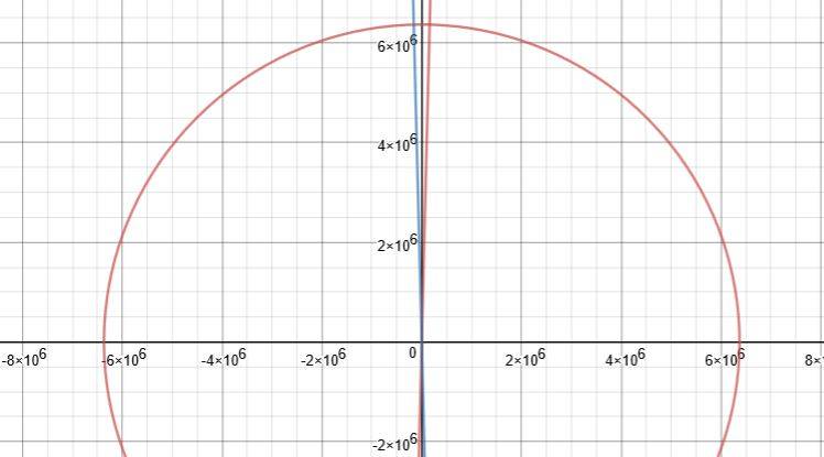

Huge suspension bridges are build with the Earth's roundness in mind. The two towers are plumb line straight up and down and yet, because of their colossal size, they are a bit further apart at their tops than they are at their base. So, how can we calculate what this difference would be?
Here is the input data:
If we know the Earth's radius; the location of the base of the towers above sea level; The distance (from the center of each base of the tower) between the bases; and the height of the tower, how would we calculate the distance from the tops of the towers.
I have seen a similar question answered once using something called "the law of cosines" where, if you know an angle and the length of two vectors, you can calculate the distances between the two vectors? I hope that helps and gives us a clue.

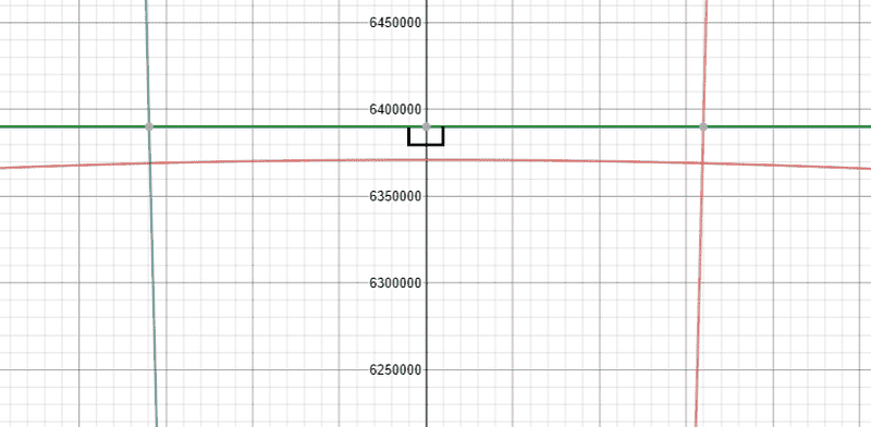

Here I am not taking a stab at solving this on my own. The first thing I noticed in trying to solve this is that the lines forming the towers of the bridge can be thought of forming two right triangles back to back:
Now, this is going way back for me -- I am talking decades -- since I last used this stuff. But, as I recall, Sine of an angle equals the Opposite side over the Hypotenuse. So, since we know what the Hypotenuse is. The angle is something we can figure out by taking the amount of the circle is taken up by the vectors.
(this shows those helpful square thingies that indicate a right angle)

So the difference in size between the top of the towers from the base is uh, 4 millimeters. In reality, it is a bit more. Where did I go wrong?
This problem can be solved in one line . Think about similar triangles and a scaling factor .
I think I am going to try some C++ code and use "long double" variables
The one line calculation gives 45.6 mm . You got the right answer actually - you just slipped a place in reading the . 0456
All you essentially needed to solve the problem though was the scaling factor : Earths radius plus the column height / Earths radius
