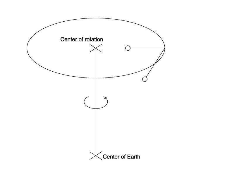

Because of the rotation of the Earth, a plumb bob may not hang exactly along the direction of the Earth’s gravitational force on the plumb bob but may deviate slightly from that direction. (a) Show that the deflection theta in radians at a point is equivalent to ##\theta = (2\pi^2R/gT^2)(\sin 2L)## where L is the latitude at the point, R is the radius, and T is the period of the Earth’s rotation.
Net force in uniform circular motion = (mv^2/r).
I started by making my coordinate system so that the x-axis aligned with the radius of the circle at a certain latitude L and the positive direction was facing away from the center of the circle, and the y-axis was parallel to the vertical axis of the Earth. Then, I wrote the equations for the net forces for both axes. Here are the equations I wrote:
(1) ##F_{x}## = ##T \cos (L + \theta) ## ##- mg## ##\cos(L)## ##= (mv^2/R \cos L)## where R is the radius of the Earth.
(2) ##F_{y} = T \sin (L + \theta) - mg \sin (L)##.
Then I solved for T from the second equation and plugged it into the first equation.
When I tried to solve for theta, I was unable to show the desired deflection angle was correct. Are my equations wrong or am I missing something else? Thank you!
Likes Delta2
Your plumb bob, and its centripetal acceleration vector, are rotating around a circle that is not coplanar with the geometrical center of the Earth and the gravity acceleration vector.
A representation of those vectors should give you the deflection theta in radians.
Please post that working. In particular, how did you replace v?
I replaced v with ##(2\pi)(R \cos L)/T## and ##mg\sin L/ \sin(L +\theta)## with T (the tension) and substituted them into the first equation to get the following equation.
## (mg \sin L/\sin (L+ \theta))## ##- mg \cos L = -m ((2\pi R \cos L)/T)^2/R \cos L##
Then, I canceled out m from both sides in the equation and then rewrote the equation as ##(g \sin L/\tan (L + \theta)) - g \cos L = -4 \pi^2 R \cos L/T^2##
Next, I added ##g \cos L## to both sides of the equation and divided by ##g \sin L## to get
##1/\tan (L + \theta)## ##= (-4\pi^2 R \cos L + T^2g\cos L)/T^2(g\sin L)##.
This simplifies to ##1/\tan (L + \theta)## ##= -4\pi^2R/T^2g\tan(L) + (1/g \tan L)##.
I'm unsure of how to further solve for theta from this.
Your last equation is dimensionally inconsistent. There is a g in the denominator in the last term that should have cancelled.
The next step is to use an approximation for small ##\theta##.

Delta2 said:
What approximation do you have in mind? to approximate ##\tan(L+\theta)=\frac{\tan L+\tan\theta}{1-\tan L \tan\theta}## by setting the numerator equal to ##\tan L##? Tried that but ... didnt work as I expected
Haven’t tried it myself, but you do have to be careful not to throw too much away early on. It might happen that the tan(L) cancels later, and if you have thrown away the ##\tan(\theta)## you'll have nothing left.
Likes Delta2
Thank you so much, I finally solved it!
