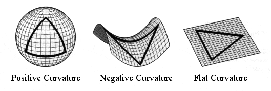

The spatial universe is believed to have one of three possible geometries
The matter in the universe began to expand before the final (Big Bang) time at some final high speed.
There are two possibilities:
If the universe has an infinite geometry (either flat or negative curvature), then it has an edge that matter has reached in its expansion. In this case, it should have a center.
Another possibility is that the universe has a spherical (positively curved) geometry and is expanding along with the matter in it.In this case there is no center. (The center is actually back in the time of the Big Bang)

No. All FLRW solutions, including the flat and open ones, are spatially homogeneous. There is matter everywhere and always was.
Likes Bosko and Vanadium 50
Wrong. The matter density in the universe is the same everywhere, even in spatially infinite universes.
No, it doesn't. A uniform infinite expanse has no center.
No, it isn't. A moment in time is not a center of anything.
