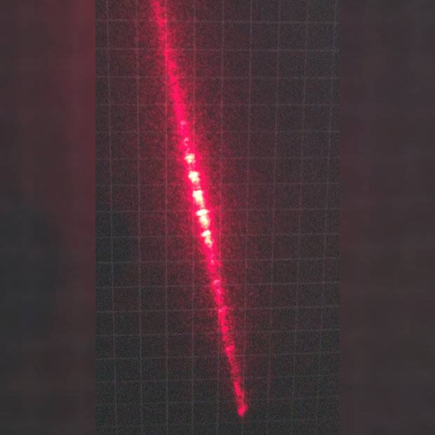

In summary, the article explores the possibility that Thomas Young may have misinterpreted the results of his famous double-slit experiment, which demonstrated the wave-particle duality of light. It discusses the historical context of Young's findings, the scientific understanding at the time, and how modern interpretations of quantum mechanics might challenge or refine his conclusions. The piece emphasizes the ongoing debate regarding the implications of the experiment for the nature of reality and observation in quantum physics.
elou
74
TL;DR Summary
In his famous double slit experiment Young claims that blocking one side makes the fringes disappear. I tried it with a single and a double slit, and I could block the fringes on one side one for one, while the fringes on the other side remained visible.
https://royalsocietypublishing.org/doi/pdf/10.1098/rstl.1804.0001 is the Bakerian lecture held in 1803 where Young talks of his double slit experiment. It is in fact a single paragraph in a much longer article. His article of 1801, which is often cited as the article in which said experiment is presented, is in fact a manifest in favor of the wave theory of light, and where no word is spoken of the double slit experiment.
Instead of slits, Young uses a card that cuts the beam in two halves. He claims that when he pushes a second card towards one of the sides of the center card, the fringes disappear on both sides. My own experience contradicts this claim, and I wonder if other people have tried it with similar or different results.
When the screen is far enough from the slit, the dark and bright fringes are clearly visible, and each fringe can consecutively be blocked by an obstacle put on the path of the beam, with no effect whatsoever on the remaining fringes on both sides.
edit:
the pattern is I think not that large. Closer to 10cm
Science news on Phys.org
How far are your slits from your screen?
How far from the slits are the obstacle you introduced?
You say the obstacle could block one fringe at a time. How big was it? And what was the fringe separation?
The screen, papered wall, is a little more than 2 meters, almost 3, and the obstacle less than a meter, The whole pattern is about 15cm. I did not measure any of these distances.
Then your experiment is not about blocking slits, it's just using the slits to generate a pattern and then using an object to cast a shadow on the wall. Your result is exactly as expected. You might, in principle, see some tiny diffraction effects around the edge of the shadow, but they'd be hard to see (at best).
If you want to block a slit, you need your obstacle to be in contact with the slits, not about a meter away.

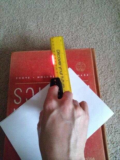

elou said:
Is there a trustworthy link to a video recording where that was done?
Here's a photo of me bouncing a laser pointer off the millimetre markings of a ruler:
Here's a photo of the diffraction pattern
Then I shifted the laser slightly so it only illuminated the half centimeter markers - i.e., I "closed" four in five of the slits.
Even with my lousy left-handed cell phone photography of an experiment jury rigged out of parts to hand you can see the pattern has changed. You can do the experiment yourself and watch the pattern change as you adjust the aim point of the laser and "close the slits".
Likes sophiecentaur, berkeman and Dale

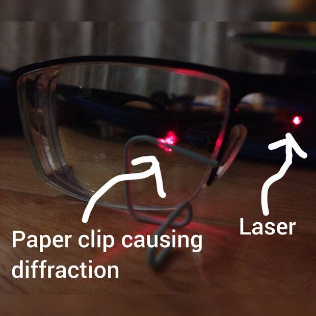

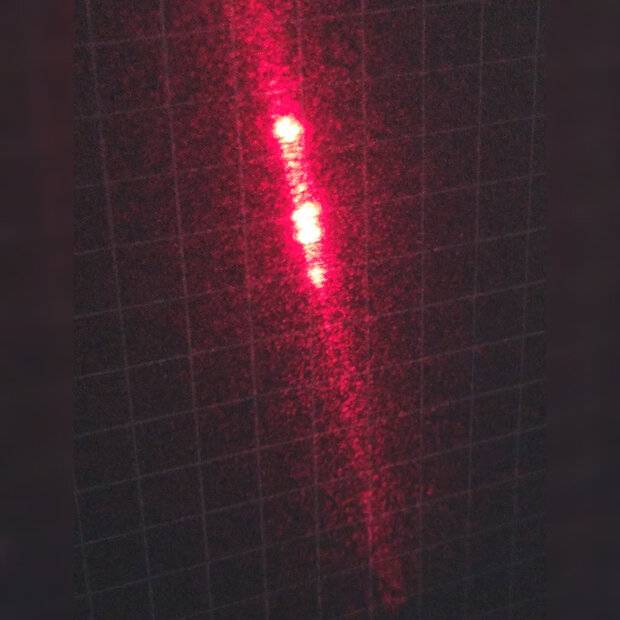

Ok, here's what you do.
You get a laser and shine it through something that will cause the beam to diverge - e.g. a pair of glasses for short sight. Then you bend a paperclip so that it can pass through the beam and place it immediately after the lens.
The diffraction pattern in the fairly near field looks like this:
The camera is rotated at an awkward angle for that shot - horizontal in reality is about 45° up to the right. You can just see fringes in the middle of it. They're much more obvious in reality, but even with the heavy post-processing I did on that they're very faint on camera. It's all washed out by the bright blobs.
Set up your screen maybe a meter from the clip (the correct distance will probably depend on your lens choice). Play around until you see fringes.
Note that the paper clip is horizontal. Get a piece of card and hold its edge parallel to the paper clip, and close to the clip - an inch or two away. Lift or lower it until you see it casting a shadow on your screen. When it starts to obscure the upper or lower bright blob you'll see the fringes between the blobs start to flow and eventually disappear.
Don't touch the table where your stuff is mounted while you're doing this or you'll wash the fringes out from vibration.
Again, this is a one-man job all knocked together in half an hour from parts to hand in my home (yes, those are my glasses, which made the rest of this a bit of a challenge, and the laser pointer button is held down by a piece of lego, a book, and my son's piggy bank). You could do a much more professional job with fairly minimal investment.

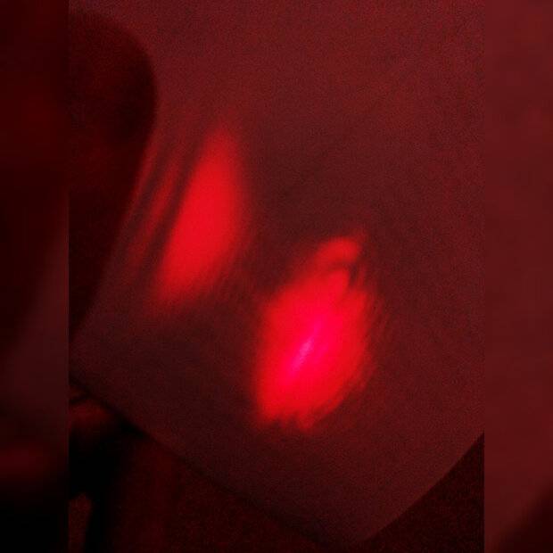

Maybe you will remember that I used a laser and dia's with single and double slits to create an interference pattern. So, I don't really understand what you are trying to prove. That certainly does not help with explaining, in modern terms, how closing a slit at once is different from closing it slowly. And how Young's explanation has been superseded by QM. Mind you, I am not saying it has not, but it would be interesting to know what that explanation is exactly.
I also have closed a slit, gradually. Until only one small dot, hardly visible, remained. So, the interference pattern did disappear, one fringe at a time.
edit: I have never seen a modern double slit experiment whereby the interference pattern did disappear because of something the experimenter did, the way Young describes his experiment. I have seen plenty of computer simulations though.
