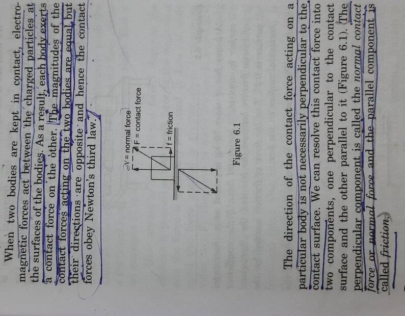

I am so much confused between normal and muscular force . The question I want to ask is that if I push or pull a body the force I am applying on the body is muscular force or normal force between my hand and block surface of contact??
OR, should I say that there is only muscular force acting between my hand and block surface??
Also ,according to my book it states that whenever there is a contact between two bodies there exists a contact force which is =√N²+f².
Please anyone help.
What is muscular force?
incursio52 said:
TL;DR Summary: I am so much confused between normal and muscular force . The question I want to ask is that if I push or pull a body the force I am applying on the body is muscular force or normal force between my hand and block surface of contact??OR, should I say that there is only muscular force acting between my hand and block surface??
Please anyone help.
A force which exerted on a body due to muscles
The muscles act internally. They don't affect the external physics directly, but are part of the internal biomechanics of your body.
