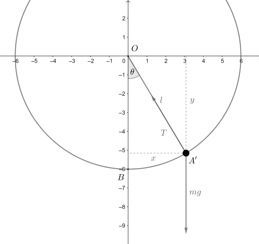

Suppose we have a simple pendulum, let's say with mass ##m##, attached to a massless string of length ##l##, on an ##xy## coordinate plane as indicated in the diagram below. I want to model the motion of this pendulum over time.
##\tau=I\alpha##
Centripetal force = ##\dfrac{mv^2}{r}##
Potential energy = ##mgh##
Kinetic energy = ##\dfrac{1}{2}mv^2##
Conservation of energy
Suppose we displace the pendulum bob ##A## an angle ##\theta_0## initially, and let go.
This is equivalent to giving it an initial horizontal displacement of ##X## and an initial vertical displacement of ##Y##. Let ##Y## initially be a negative number, and ##X## initially be positive.
I observe that in this initial state, it has some potential energy ##mg(l+Y)## with respect to point ##B##. This energy must be conserved.
Next, we look at some such general position as ##A'## of the pendulum bob, where its horizontal and vertical displacements are ##x## and ##y## respectively (##y<0##), as shown below. Let us suppose it has a net velocity ##v## at this instant. Let ##\theta## be the angle it forms with the vertical, and consider this angle to be negative.
Here, the bob would have lesser potential energy, and the difference, will have converted into its kinetic energy. So we have

Now this pendulum is also undergoing non-uniform circular motion, so there must be a centripetal force directed towards the center to keep it going in the circle. This force must be provided by the tension force ##T## and the component of the weight force along the string. Therefore,
\begin{align*}
T-mg\cos\theta&=\dfrac{mv^2}{l}\\
T&=mg\cos\theta+\dfrac{mv^2}{l}.
\end{align*}
We know ##v^2## from the Principle of Conservation of Energy, so
T=mg\cos\theta+\dfrac{2mg(Y-y)}{l}.
Now, we resolve the forces on the pendulum bob vertically and horizontally, and use Newton's Second Law to find the accelerations in these directions. If the net horizontal acceleration in the right direction is ##a_x##, and net vertical force in the upward direction is ##a_y##, we have
\begin{align*}
a_x&=\dfrac{T\sin\theta}{m}\\
a_x&=g\cos\theta\sin\theta+\dfrac{2g\sin\theta (Y-y)}{l},
\end{align*}
and
\begin{align*}
a_y&=\dfrac{T\cos\theta-mg}{m}\\
a_y&=g\cos^2\theta+\dfrac{2g\cos\theta (Y-y)}{l}-g\\
&=\dfrac{2g\cos\theta (Y-y)}{l}-g\sin^2\theta.
\end{align*}
We can also say that ##\sin\theta=\dfrac{x}{l}## and ##\cos\theta=-\dfrac{y}{l}##.
The net horizontal and vertical accelerations ##a_x## and ##a_y## that the object experiences, in terms of its position ##(x,y)## are therefore
a_x=\dfrac{gx}{l^2}\left(2Y-3y\right)
and
a_y=-\dfrac{g}{l^2}\left(x^2+2y(Y-y)\right).
Is this correct?

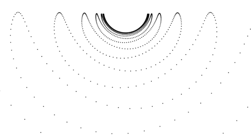

I am trying to model the motion of a pendulum in space. My approach is as follows.
I choose an initial position for the pendulum given by the Cartesian coordinates ##(X,Y)##, and have a computer program evaluate its horizontal and vertical accelerations at that position.
I then choose some small time interval ##t##, (say about ##0.001\text{ s}##), and multiply each the horizontal and vertical accelerations by ##t##, to get the change that must happen in the pendulum's horizontal and vertical velocities respectively at that instant. These velocity changes get added to variables storing its velocities.
I multiply the net velocities of the pendulum again by ##t## to get the changes that must happen in its displacement, horizontally and vertically.
These displacements are added to ##X## and ##Y## to get its new position, and the whole process repeats.
Clearly there must be errors in this process, but I believe it works well enough for small values of ##t##.

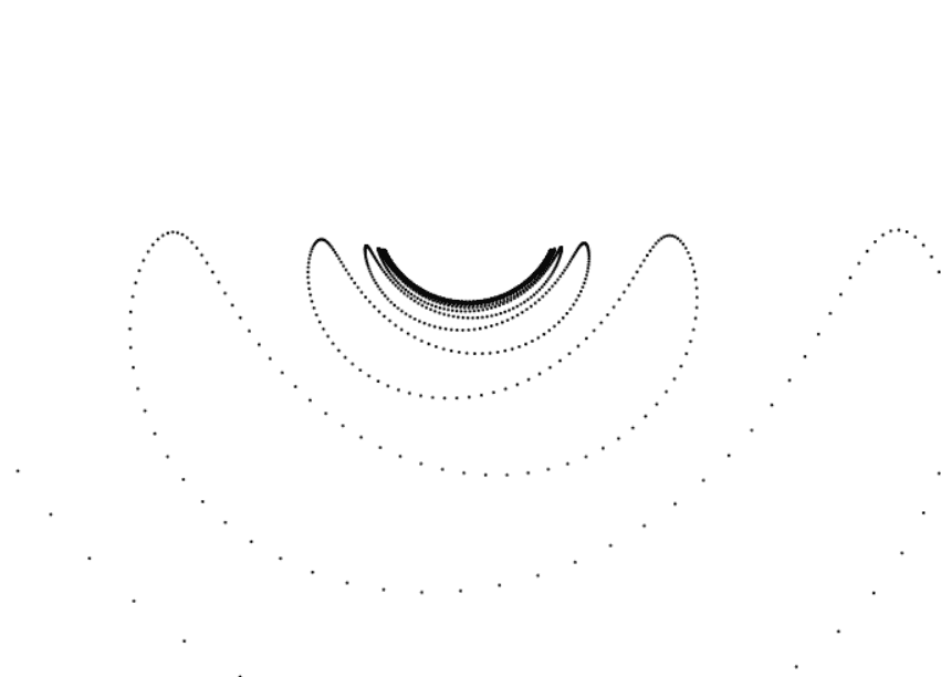

But for ##X=60## and ##Y=-30##, this is the path I find is traced out by the pendulum :confused:
I still believe this would happen with the previous case as well, if I look at it for long enough. Why might this be?

I wonder if you'd be happy to post your code? It might be easier to fix that way. Could be something as annoying as too small a step size, with small errors being exacerbated; have you tried lowering that?

I believe this will do. I haven't included the part where the particle is actually drawn.
JavaScript:
var xVelocity = 0, yVelocity = 0, g = 1000;
var initX = 60;
var initY = -30;
var prevX = initX, prevY = initY;
var l = Math.sqrt(Math.pow(initX, 2) + Math.pow(initY, 2));
var time = 0.001; // The particle is made to move for this long
function f(x, y) {
    var i = -((g*x)/Math.pow(l, 2))*(2*initY-3*y); // Coefficient of unit vector i
    var j = -(g/Math.pow(l, 2))*(Math.pow(x, 2) + 2*initY*y - 2*Math.pow(y, 2)); // Coefficient of unit vector j

This might well be a way to do it, but I wonder whether the incremental displacement should instead be quadratic in ##t##? As in
JavaScript:
var xOffset = xVelocity*time + 0.5*output.i*Math.pow(time, 2);
I wonder also whether this should go before you increment the velocities, I think it should.

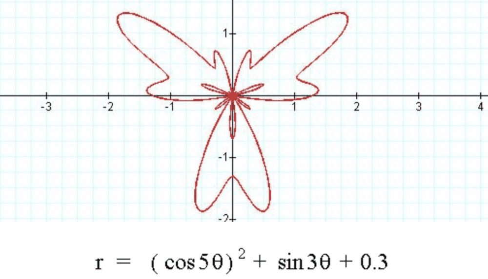

PeroK said:
:frown:
You've seen polar bears... now wait until you see the polar butterfly!
Likes PeroK

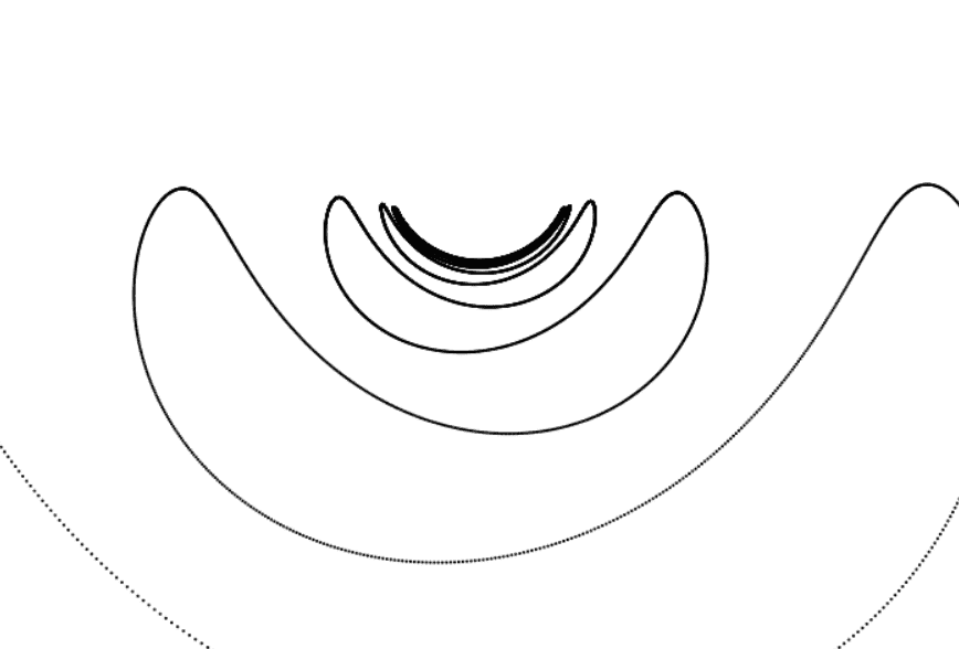

Thank you very much for these suggestions :smile:. But I get the following with
JavaScript:
var xOffset = xVelocity*time + (output.i*Math.pow(time, 2))/2;
var yOffset = yVelocity*time + (output.j*Math.pow(time, 2))/2;
xVelocity += xVelocityChange;
yVelocity += yVelocityChange;
With
JavaScript:
I get this.
This appears to be an improvement 🤷‍♂️, but it's not a single line---notice how the line is quite thick. It initially moved towards the center, and then moved outwards again. Can this happen?

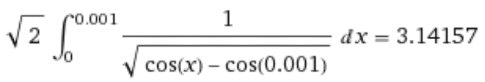

That's kinda peculiar behaviour, if in your ##\delta t = 0.001## you can approximate the acceleration to be constant, then you should have ##v_x = u_x + a_x\delta t## and ##\delta x = u_x \delta t + \frac{1}{2}a_x {\delta t}^2##. In each case the ##u_x## is xVelocity before increment by ##a_x \delta t##. But if you've got it to work like that, then who am I to complain :cool:!

Simulations like these have a slight tendency to go slightly mad unless everything is really finely tuned; I'm presuming this is because in each recalculation of position you slightly overestimate the displacement of the pendulum bob. There are only two things that I can think of that might help. First decreasing ##\delta t## (you might have already tried this above, the lines look slightly denser).
Secondly, try putting in a very slight damping force. This should amount to just a small change in your function f(x,y), something like adding a ##-k \times \text{xVelocity}## into your expression for i, and the same for j. This might help to counteract that crazy behaviour you're getting.
