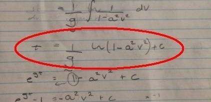

Solve the differential equation, dt/dv= 1/g (1/1-a^2*v^2) where a = (k/mg)^1/2 to yield v= 1/a(1-e^-2agt/1+e^-2agt).
F=ma
Newton's 2nd Law
Integration Laws
See image. I think I'm getting messed up on the integration laws.

Great!
Now back to the exercise:
Something went wrong in the part I circled in red.
The derivative of ##\log (1-a²v²)## is ##\frac{-2av}{1-a²v²}##.
EDIT: To fix the error above: the derivative of ##\log (1-a²v²)## is ##\frac{-2a²v}{1-a²v²}##.

Yeh, I know there is probably an issue here in my work, but I wrote: ##\ln (1 - a^2 v^2)## when derived, this gives ##\frac{1}{1-a^2 v^2}## doesn't it?

No, it gives ##\frac{-2a²v}{1-a^2 v^2}## (I forgot the a² in my previous post).
You have to apply the chain rule.
If ##f(x)=\ln g(x)##, then ##f'(x)=\frac{g'(x)}{g(x)}##.

Yeahh I'm really stuck on this one. I don't know how I can get my ##g'(x) = 1## whilst the bottom ##= 1 - a^2 v^2##??
So now you can solve that to get v in function of t.
Remember that ##\ln \frac{b}{c}=\ln b -\ln c##.
