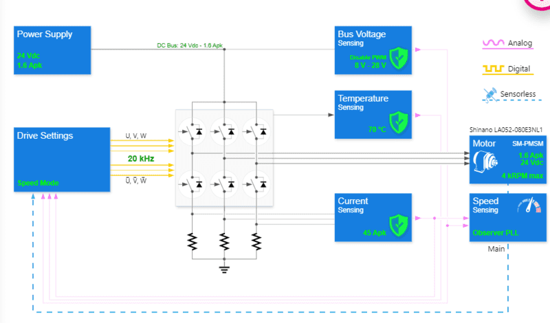

I have a great difficulty in understanding the current and voltage ratings of the inverter, at the input of the inverter the ratings are different compared to the output side. What are the formulae of those conversions example,
If i check the above diagram, power supply is 24V, 1.6APk
a. Does it mean the inverter is designed for 24*1.6 = 38.4 Watts?
b. Power is constant can the voltage and current can be different to maintain power, ex: 12V, 3.2A pk = 38.4 Watts? Will there be any limitations on that i mean lower limit on voltage?
c. The motor specifications are again the same, so i need to select a motor which meets my power supply requirements or i need to design an inverter for a motor?
d. Most important is in the current sensing it can read upto 45Apk, when my input is only 1.6A pk why it is required to measure on power side of 45A? How much maximum current flows through and what is the equation to derive it? Please advise.
Most of your questions can be answered by finding the specifications for the inverter. Without those I think we're simply playing a guessing game.
Inverter specs are often confusing. You are jumping into the deep end of the pool here. Peak amps is hard to relate to other things, like power. This one I would just take at face value; i.e. you know the peak current but not much else. If they really wanted to describe the limitations of this circuit, they would need more numbers and words to go with them. Often the specs you see only relate to what the user has to do/expect, not how the circuit works. The real answers are too complex for their customers.
