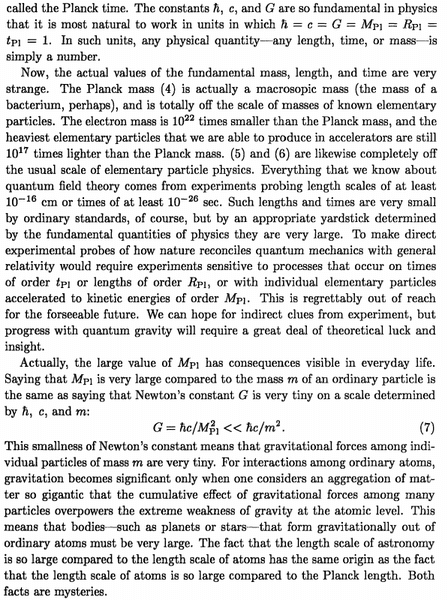

That's good stuff. What got me confused, among other things, was the Bronstein cube, that also appears in the opening chapter of Zee's "Einstein gravity", which makes you think that by increasing c, h or G gets you deeper in the domain of the respective theories.

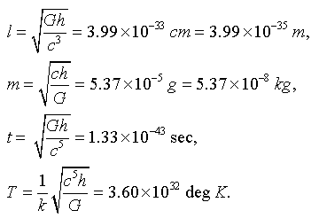

Perhaps, one final question. What physical meaningful observation/ conclusion can we make about the Planck units? They are special units after all, ratios of three (dimensional) constants. The fact that the Planck mass is many orders higher than Planck time and length, would be one, as I read many time before. Anything else?
The Planck mass is a unit of mass. It can be neither greater than nor less than a unit of time. The two are not commensurable.
The fact that the Planck time (in seconds) is numerically less than the Planck mass (in kilograms) is as much a factoid about the size of the second and the kilogram as it is a factoid about the size of the Planck time and the Planck mass.
Likes Lapidus and Vanadium 50

But when we compare Planck mass and Planck time with other mass and time scales. Like described here
Well, that also depends on your system of units. In geometrized units mass and time both have units of length. So in geometrized units it does make sense to compare the Planck mass to the Planck time. In those units they are equal.
Likes Lapidus and jbriggs444
