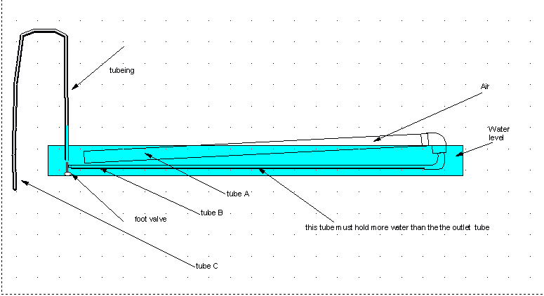

In summary, a 32mm x 1 metre pipe (A) running from the stern floor (open end) forward with the front end raised 100 mm, then turned 360 deg and reduced to 10 mm (pipe B) back to the stern floor alongside pipe A, at the stern end of pipe B fit a T 10 mm connecter with a foot valve and another 10 mm pipe rising vertically for 600 mm (pipe C) over the transom and continuing down for 800 mm with the tide out would create enough pressure to raise the water 600 mm in pipe C.

I'm trying to create a dinghy rib automatic start syphon system, to drain the water out of dingy every time it rains, Kindly do not post any alternative systems that require a power supply other than free power i.e. wind or wave.
The theory is that that the trapped air in pipe A would create enough pressure to raise the water 600 mm in pipe C,
Design and parts: 32 mm x 1 metre pipe (A) running from the stern floor (open end) forward with the front end raised 100 mm, then turned 360 deg and reduced to 10 mm (pipe B) back to the stern floor alongside pipe A,
At the stern end of pipe B fit a T 10 mm connecter with a foot valve and another 10 mm pipe rising vertically for 600 mm (pipe C) over the transom and continuing down for 800 mm with the tide out,
The water level is always slightly higher inside when it rains than sea level, but the difference would be considerable different when the tide goes out.

Roger T said:
How much pressure would it take to push water up a 10mm x 600mm pipe?.
You said the vertical rise is 60 mm, not 600. That is the significant number. Diameter doesn't matter. (I would have guessed closer to 250 mm vertical rise is needed).
60 mm head gives 0.006 bar pressure.
Hi, Sorry about that typo, yes 600mm I have edited that & modified the drawing,
Assuming that you start 'dry' - no water in the 'inverted U-shaped' hose:
The pressure of the trapped air cannot exceed the static head of the water in the boat. The water in the 'U-tube' will rise exactly to the level of the water in the boat, and only that high (ignoring a little capillary action). Your system could work (and empty the boat) after the water level in the boat exceeds the elevation of the high point of the 'U tube.' A too-large' siphon hose (or a too-low rainfall rate) could cause the system to act as a simple overflow drain and never allow the 'full hose' condition required for a siphon to occur.
Hi Dullard,
Yes all tubes start dry, the water level that I'm showing in the diagram is to show the air that is trapped, it normally ends up three times as high in wet spells, if the system started to syphon obviously it would not get to that height, but the more water the more pressure created, the weight of the water in the U pipe is only .o5kg, this is effectively reversing the principle of the hydraulic car jack, by using 32mm tube down to 10mm, if 1psi with a 1" piston will lift 1 lb I think it will work, would just like to know what pressure the 32mm pipe is likely to produce,
The 32 mm pipe will be at a pressure equivalent to the head of the water in the boat - the higher the water, the higher the pressure. It will be exactly enough pressure to raise the water in the outlet tube to an equal height. Your 'hydraulic jack' analogy is just wrong - the pressures here are due to gravity.

The 32mm tube would raise the water in the outlet pipe to the same level if it was 32mm, butt it is 10mm, the analogy of the jack was purely to demonstrate by turning it upside down, push fluid large into small, instead of small into large in the case of the jack, and yes we are applying pressure with physical force proving that it is a long stroke with a small piston moving a heavy weight a tenth of the distance, without going into it 50 kg of force was lifting 400 kg,
As an example if the small pipe is 25% area of the large pipe & pushed the the fluid in the large pipe 100mm the fluid in the small pipe would move 400mm and the forces required to lift .05 kg could be as little as 1 to 2 psi.
A column of water isn't a piston - it's like a piston that 'gains weight' as you elevate it. The pressure at the bottom of a column of water is independent of the pipe size - it depends only on the height of the water column. You are 'pressurizing' the trapped air with water in the boat. The water in the siphon hose will rise until the pressure at the bottom of that column is the same as the air pressure - the water level in the boat and in the siphon hose will be the same.
