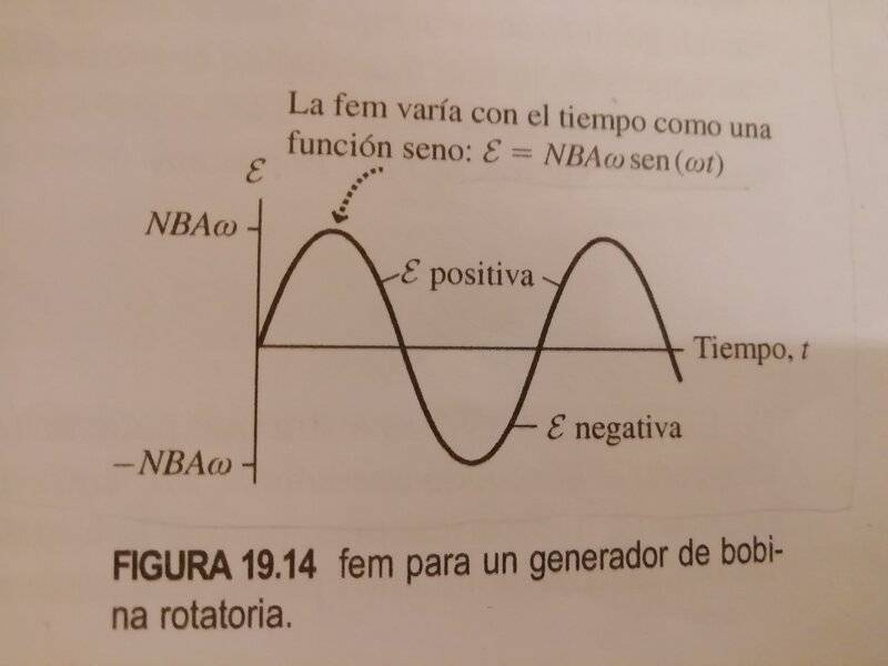

(...) How does an electric generator work? We know from Faraday's law, that the induced current requires a variable magnetic flow. With a uniform field, we have the equation ##\Phi=BA\cos{\theta}## for the flow that goes through each turn of a coil (a moving magnet induces a current in a coil ) The magnetic field ##B## and the area ##A## are constant, but as the coil turns, the angle ##\theta## changes. If the coil goes round with a constant angular speed ##\omega##, then we know from a previous chapter that ##\theta=\omega\,t##. Thus, by Faraday's law, the emf will be
$$\mathcal{E}=-N\displaystyle\frac{\Delta\Phi}{\Delta{t}}=-N\displaystyle\frac{\Delta{(BA\cos{\theta})}}{\Delta{t}}=-NBA\displaystyle\frac{\Delta{(\cos{(\omega\,t)})}}{\Delta{t}}$$
for a coil of ##N## turns. Applying calculus tools, we deduce that the above formula leads to a instantaneous value
$$\mathcal{E}=NBA\omega\cos{(\omega\,t)}$$ o_O
Thus, the induced emf changes sinusoidally with time, periodically turning from positive to negative values. This renders an alternating current, which switches direction regularly. The electric supply travels through power lines to houses and offices.
