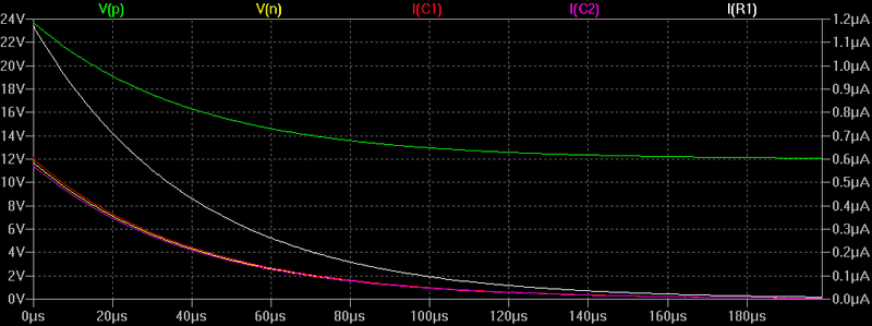

  • #49
cianfa72 said:
Ah ok, you did a simulation using LTspice. C1 and C2 are both discharged through R1 since the current through R1 is always the sum of I(C1) and I(C2).
Simulation programs can be a snare and delusion because they tend to make assumptions about those components in a circuit that you don't specify (or even notice). You should hesitate to conclude that the software 'got it wrong'; it just tried to help you by filling in the gaps in your data with its own estimates.
It's incredibly easy to find a disagreement between what your basic theory and a simulation tells you. So beware and choose the direction of what the basic theory tells you. When there's a problem then start looking for something that your basic approach has missed or failed to specify. EMFs can be difficult to quantify.
  • #50
With reference to the simulation in post#22, from my previous work, LTspice uses a Thevenin voltage source with a series resistor of 2 mOhm (or 500 Siemens Norton conductance) to drive the node referenced in the .IC V(nxx)=<value> global directive.
In this case the node Vp is driven with a Thevenin voltage source of 24V with a series resistor of 2 mOhm. With .tran simulations, LTspice evaluates first the Initial Transient solution (aka initial DC solution) opening the capacitor and shorting the inductors. Therefore in our case (before the grounding switch is turned on) the Initial DC solution for node Vn is 24 -12=12V w.r.t. ground. It is also the state initial condition for the numeric integration of the C2 capacitor voltage.
Said that I believe, as @Dale pointed out before, that even the battery EMF is "responsabile" for the charges stored on the battery's terminal/ground capacitors (i.e. C1 and C2 in the model). Consider the following: suppose no external charge is placed on the battery terminals and the inter-terminal capacitance is negligible. The PDs between each terminal and ground cannot be both zero. Hence the battery EMF must charge someway the battery terminal plates.
  • #51

  • #54
Dale said:
Sure. The small capacitance between the terminals and ground is different from the internal capacitance.
When I simulate the terminal capacitance, with an ideal voltage source as the battery, the simulation behaves reasonably.
When I replace the ideal voltage source with the 80kF and 4kF capacitor battery model, I get digital noise. That is because the terminal capacitance has then become insignificant. 80kF to 1pF gives sixteen orders of magnitude, that cannot be simulated with the 16 digits of double precision floating point.
When I reduce the battery model from kilofarads to millifarads, the simulation works well again, as well as it does with the simple voltage source. The ratio is then 80mF to 1pF, ten orders of magnitude, well within the dynamic range of double precision.
Battery voltage is then stable at 12.000 volts.
I(C3) is between 1 fA and zero, that is one LSB of double precision.
Notes:
1. I have staggered the values of C1 and C2, to separate the lines on the plot.
2. The schematic of the voltmeter switch looks real, but the virtual switching is actually done by the .IC initial conditions, applied at t=0. The switch is always closed by the shared node "n" label.

Ps. how did you draw the slanted line for the switch in LTspice schematic ?
Draw a short orthogonal offset wire. Select the free end, then "drag" it to a diagonal line. You can "move" that line segment if you need to.
You may need to change the drafting options.
  • #58
Baluncore said:
Dale gave a link to it in post #42.
"Temperature-Dependent Battery Models for High-Power Lithium-lon Batteries"
Ah ok. With this battery model the initial conditions V(p) and V(n) are actually two folded. They implicitly assign "external electrostatic charges" on terminal/ground capacitor C1 and C2 and at the same time "charge" the battery (i.e. charges the internal capacitors Cc and Cb and the inter-terminal capacitance C3). The .tran simulation starts from these initial conditions: the ground switch via the 10meg voltmeter discharges the external electrostatic charges from C1 and C2, meanwhile the PD at battery terminals stays put and the inter-terminal capacitance C3 isn't discharged at all.
  • #59
Correct.
That is why we can ignore C3 in the "flying battery" circuit model.
C3 is dominated by the fixed battery voltage; C⋅dv = dq = zero.
