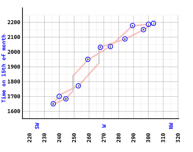

This the data, graphed.
Kind the antithesis of smooth...
I've compensated for daylight savings (two vertical segments - Mar 12 to Nov 5) that I assume to be in the data.

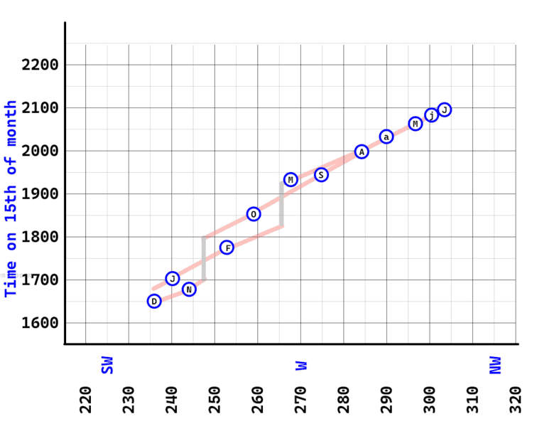

If I do not compensate for daylgiht savings, this is what it looks like:
Neither one looks to me like a smooth annalema (even if I gave it smooth curves).
I've checked the data a half dozen times. Don't know what I'm doing wrong. Maybe it's not me; Maybe HA is playng fast and loose with sunsets.

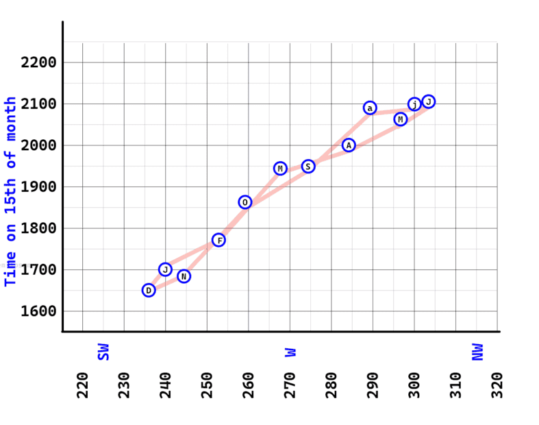

I checked the Heavens Above data against Stellarium.
Month (15th of)TimeΔTBearingΔ°
Jan1703240.5
Feb1745+42253+12.5
(Mar 12)(-60)
Mar1921+96267.5+14.5
Apr1958+35284+16.5
May2033+34297+13
Jun2058+25303.5+6.5
Jul2054-4301-2.5
Aug2019-26290-11
Sep1926-53274.5-15.5
Oct1832-54258.5-16
(Nov 5)(+60)
Nov1650-102244-14.5
Dec1638-12237-7
Stellarium has explicit sunset times listed, rather than me just setting alt to <±1°. (As I said, the sun sets obliquely, so a small diff in time can produce a large difference in azimuth).
This data produces a much cleaner graph.
A=April, a=august, J= Jun, j=July
(The discprenacy in the left edge of the curve is because the sun doesn't start in the exact same place on Jan 1, 2023 as it ends on Dec 31, 2023).
So, in conclusion:
  • At 45° North, the sun sets in the range of ±35° of due West.
  • Sunset is due West near (but not necessarily on) the March and September equinosees (because: eccentricity).
  • Its azimuth will change by as much as a half degree per day (~16° over 30 days) at those times.
  • Over Christmas, its northerly limit, the sun sets as far north as 303.5°, just 5° shy of due NorthWest.
