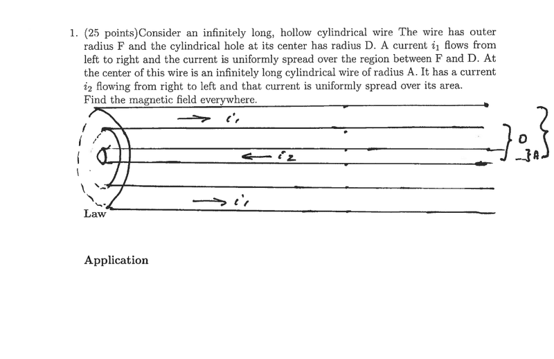

I have already solved for the magnetic fields everywhere AND THE magnetic field at R>F = (U/2*PI*R)*(I2-I1)
My only problem is i know i use the right hand rule to determine the direction of the magnetic field B as clockwise or counter clockwise, however there are 2 currents i2 and i1 so which current do i put my thumb to determine the direction of B at R>F?
This is incorrect. Your expression in the region R > F is missing a denominator. Anyway, since your expression has (i2-i1), put your thumb in the direction of i1 and do the right hand rule thing. Ultimately, the direction the B-field will depend on which of the two currents is greater than the other. If your are given that i2 > i1, then the direction will be as you have chosen, else it will be the opposite direction.
They didnt say which is greater than the other in the question stated above, so how can i know?
You can't possibly know unless you have numbers or at least someone tells you which current is greater than the other.
