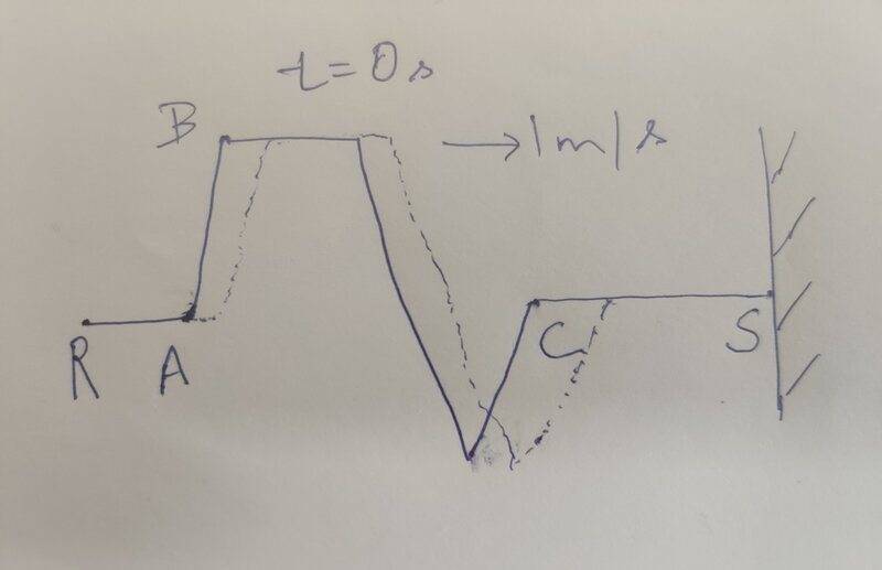

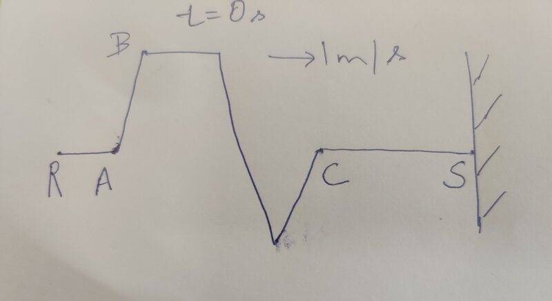

A rope RS has a pulse at ##t=0## traveling towards the right at ##1 m/s## as shown in the first diagram below.
What will be the direction of motion of points A, B and C at ##t=0##?
None
The second diagram is my attempt at the solution, in which the dotted part is the pulse in the rope a very small interval of time after ##t=0##.
Point A should be at rest since we know wave is moving towards right and point A on the rope becomes a part of initial horizontal part of the string a moment after ##t=0##.
I am still trying to figure out the reasoning behind the direction of motion of points B and C.

Your diagram is good, making it quite easy to see where B and C have moved to on the dotted line. Try marking them as B', C'.

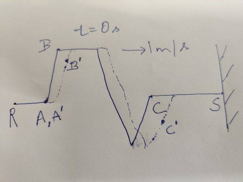

I am assuming that the length of rope from point ##R## upto points ##A, B, C## will be a constant for each point in question i.e. lengths ##RA, RB, RC## are going to be constant. We can also say that ## RA=RA'##,
## RB=RB'## and ## RC=RC'##.
With above assumption, I came up with following diagram for new positions ##A', B', C'##. It seems as the interval of time for dotted wave approaches ##0##, ##B'## approaches a position vertically under ##B##; similar reasoning will apply to ##C'##.
So, points ##A, B## will be moving vertically down at ##t=0##.
If my reasoning in post#3 is correct, then is there
an alternate easier/shorter reasoning?
Again, your diagram is good, though in the usual idealisation of a transverse wave the elements do not undergo any longitudinal movement. That also leads to the answer you arrived at.

vcsharp2003 said:
So, points A,B will be moving vertically down at t=0.
Sorry, the above statement should be as below.
So, points ##B, C## will be moving vertically down at ##t=0##.
Note: I could not edit my post#3 and therefore, I am posting a correction here for others.
