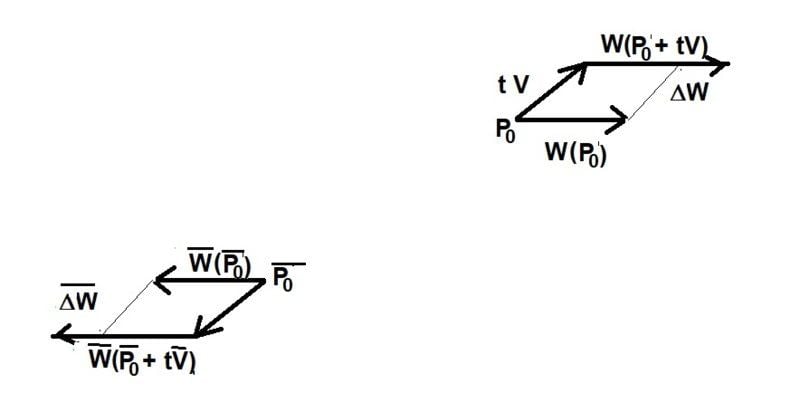

It seems to me that you have: (letting ##\mathcal{P}## be the point with coordinates ##(x,y,z)## and ##\overline{\mathcal{P}}## be ##(-x,-y,-z)##.
##\overline{W}(\overline{\mathcal{P}}) = - W(\mathcal{P})##
##\overline{W}(\overline{\mathcal{P}} + \lambda \overline{V}) = - W(\mathcal{P} + \lambda V)##
##\Delta \overline{W} = \overline{W}(\overline{\mathcal{P}} + \lambda \overline{V}) - \overline{W}(\overline{\mathcal{P}}) = - W(\mathcal{P} + \lambda V) - (- W(\mathcal{P})) = -\Delta W##
Roughly speaking, ##\nabla_V W = lim_{\lambda \rightarrow 0} \Delta W##.
(I say "roughly speaking", because you can't directly subtract vectors at different points in space. But you seem to be assuming a flat, Cartesian coordinate system).

Why doesn't ##V## change its sign, from ##+tV## to ##-tV\,?##
It did. The key fact is that we're mapping both vectors and positions. So if ##\mathcal{P}## is a location, then ##\overline{\mathcal{P}}## is the mapped location. The relationship between ##\overline{W}## and ##W## is this:
So ##\overline{W}(\overline{\mathcal{P}}+ t \overline{V}) = - W(\mathcal{P}+ tV)##
On the left-hand side, ##\overline{V} = -V##.
This is how I see it: ##\nabla_\overline{V} \overline{W} = lim_{t \rightarrow 0} \overline{\Delta W}##, which is just the negative of ##\Delta W##.
