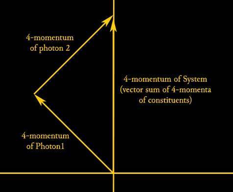

filegraphy, does this Minkowski diagram help? It shows the 4-momenta of a pair of photons of equal energy traveling in opposite directions in a frame of reference in which the vector sum of their 3-momenta is zero. The timelike axis is vertical, and the spacelike axis horizontal.
The mass, m1, of Photon 1 is
[tex]m_1=\sqrt{(E_1)^2-(p_1)^2} = 0[/tex]
where E1 is its energy and p1 is the Euclidean norm (magnitude) of its 3-momentum, and E1 = p1. Similarly for Photon 2. In this case, E1=E2, and p1 = p2. The only difference between the photons is that their 3-momenta are in opposite directions.
The mass of the system of two photons is
[tex]m_s=\sqrt{(E_1+E_2)^2-\left \| \vec{\textbf{p}}_1+\vec{\textbf{p}}_2 \right \|^2}[/tex]
[tex]=\sqrt{(E_1+E_2)^2-(\vec{\textbf{p}}_1+\vec{\textbf{p}}_2) \cdot (\vec{\textbf{p}}_1+\vec{\textbf{p}}_2) }[/tex]
The reason it's not zero is that 3-momentum is a 3-vector, and non-zero vectors can add to zero. Here, the 3-momenta of the two photons are equal in magnitude but opposite in direction, so they sum to 0. On the other hand, energy doesn't care about direction in space; here it's just a sum of two positive numbers. There's no 3-momentum to cancel it out, so the mass of the system is sum of the energies, and thus not zero.

Another diagram. You can visualise addition of 4-momenta like this on a Minkowski diagram. Put the head of one vector to the tail of the other and draw the vector representing their sum from the tail of the first to the head of the second. See how the 4-momentum of the system, unlike those of its individual constituents, has no spacelike component (3-momentum) to cancel out the timelike component (energy) in the equation for mass (which is the magnitude of 4-momentum). The energy is the system in this particular reference frame, its center-of-momentum frame (that is, one where it's 3-momentum is zero), is equal to its rest mass.
