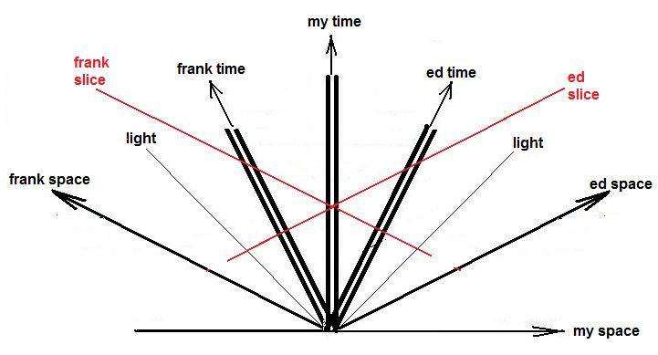

OK. You guys got me doing more homework than I ever did in jr. college physics and algebra classes. But this is really getting to be neat stuff. I feel like I'm being a physicist. So I played around with the hyperbola graphs in Microsoft Excel and came up with this one after going thru Shutz and going back to some things Dr. Donis said about slices and came up with a slice. What's amazing is how the slice explains why the moving guy sees an earlier time on my clock world tube (don't worry I know that you have to take into account how much time it takes for light to get there before you can see and I don't care about that right now because these basic ideas are what's really got my brain spinning). You were really putting me in the right direction Mr. Fredrick when you said to dig into spacetime pictures thank you.
I marked times t1 t2 and t3 to show these times are all the same since they are on the hyperbola. t4 is the time on my world tube clock that the moving guy would see in his slice of 4dimensional spacetime that Dr. Donis told me about. I really used ct for the time axis to get the units suggested by Mr. Fredrik.
Now I can't say this for sure but it looks like the space direction for the moving guy is always going to be a tangent line to the hyperbola.

  • #39
Yes, that's correct. You can actually prove this mathematically.

  • #64
Ideas on 4 dimensional universe physics
We played pool Saturday night and then went to Ray's Bar-B-Q and
had a big bull session about relativity. No one could believe
all the things I learned about relativity and the my cousin and
Frank got into another big argument about whether the universe
was 4 dimensional all at once and it seemed like they were getting
a little angry. Frank said that ether theory didn't have anything
to do with it but the universe is just 3 dimensions and is always
changing and that the 4th dimension is just for mathematics
calculations. I told my cousin that some people said the the
4 dimensional universe all there was just philosophy and not real
physics but he asked me if Einstein was just doing philosophy
before special relativity was proved and if he was just doing
philosophy before general relativity was proved. My cousin says that
Einstein's idea that the universe is 4 dimensional all there at once
is really physics and not philosophy because the world tubes and
slices are predicted by the mathematics. But I did not like the
arguing and Frank and my cousin getting angry so I will not cause
any anger like that here and ask any more questions here.
I printed out my spacetime picture that I did here and told him
about making a symetric one so he added on another moving world tube
going in the opposite direction and showed me that each mover saw
the other's world tube slice to be shorter than his own and that
each one saw an earlier time on the other one's world tube. So I
went back to my room and made it up for my last post here. I played
like my cousin is moving away from me to the right and Frank is moving
away from me to the left at the same speed.
  • #65
Just to be clear, nobody here has been saying that SR or GR are just philosophy. We have only been saying that the "block universe" or "ether theory" *interpretations* are just philosophy. SR and GR are certainly scientific theories; they make plenty of predictions about experimental results, and those predictions have been verified, in some cases to ten or more decimal places.
Stricklandjr said:
My cousin says that
The world tubes and slices are indeed there in the mathematics, but they by themselves don' t prove that "the universe is 4 dimensional all there at once". That's a much stronger claim.
  • #66
Stricklandjr said:
My cousin says that
The thing that I like about math is that there is generally more than one way to write the same thing, and due to the logical framework of math itself, you are guaranteed that both ways of writing are logically equivalent. So, if the world is 3D evolving in time then we would write the position of a particle as follows:
[itex](x(t),y(t),z(t))[/itex]
But we are always free to replace [itex]t[/itex] with some function [itex]t(λ)[/itex], and we can write [itex]x(\lambda)=x(t(\lambda))[/itex]. So now we can write a completely equivalent expression for the position of a particle like this:
[itex](t(\lambda),x(\lambda),y(\lambda),z(\lambda))[/itex]
This last expression is what we would write if the world is 4D. So, mathematically, the 3D and 4D worlds are completely equivalent and you can always mathematically rewrite any expression from one form to the other. It seems intuitively like there should be some phenomenal difference between the two, but there isn't. Logically (rather than intuitively), a 3D time evolving world is completely equivalent to a 4D world.
