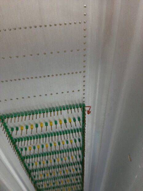

TL;DR Summary
We are dealing with extremelly thin (radius of order in mm) wires of gold at the project i am. It is necessary to plug these wires at a copper plataform.
We have think two ways to do that: To weld it, or, to buy a plug that allow us to do that.

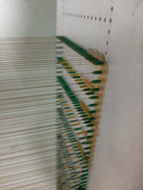

SInce to weld it is the second option, we are searching if the plugs are still on selling/on market. The idea of using a plug was from the manufactory's sir. He has showed to us a image of the plugs he talked about (aparently, he has used it, but was a long time ago, so he is not sure if it still exist):
(outside the apparatus)
(inside the apparatus)Do you know it? (Maybe the commercial name, or a place to buy it)
Thank you.
Is it soldered or crimp like a bootlace ferrule?
What diameter wire?
What material wire?
What diameter external terminal?
https://www.digikey.com.au/en/products/filter/terminals-pc-pin-single-post-connectors/323
Search in results for “insulated”.

It is crimp. The wire is made of gold.
This site is a good reference! THank you. I will go on searching for.

Ok. Someone has moved my topic to a place where i think it should not belong. As always, i think i was not clear enough to clarify my ideas/questions. Let me try to be more specific.
We have a lot of thin wires made of gold, whose diameter is ##25 \mu m##. These wires need to be connected to a plataform, and here is the main point. We could, like a circuit, to weld the wires at the plataform. The problem is that they are too thin, and they should all be tensioned. To weld it will demand copper, and we need this copper to do another things, so we have decided that to weld is the last option.
The other idea, which is the focus of this topic, is to make little holes at the plataform, so that these wires, instead being connected to the plataform, pass through it. We would use these material at the question to hold/tie the wires.
Essentially, these materials are equivalent to use bushings to hold nails. Instead of nails, we have thin wires, and instead of bushings, we would have this material at the OP.

Welding is not the only option for bonding gold. Gold jewelry is usually assembled from parts using appropriate grades of gold solder. It's sometimes referred to as brazing too. If you need many gold wires to be soldered into holes in a plate (brass / gold / what?) then they could all be inserted, 'dry' into their holes (some steady work holding necessary) and then solder would be flowed onto the back of the base with a suitable flux and of solder alloy. (This is very similar to the way printed circuit electronics boards are made these days.) All the wires would become bonded at the same time.
It's already been stated that the details of the construction are needed if we are to go any further. How many wires, what spacing, what is the material of the base etc. ? If the OP is shy of describing the project then he may have to be disappointed that we can't help him more.
PS is the OP worried about the temperatures involved? Appropriate grades of solder would solve that problem.

The tungsten corona wires in photocopiers are mounted with a preset tension. You might look for the insulated pins used in earlier photocopiers and laser printers to support those wires. Ask an older technician what terminal was used in the first generation machines.
If you want a spring-loaded termination that will maintain tension on the wire then you might adapt a test probe or pogo pin.
Search eBay for; “pogo pins”, Or; “spring test probe”.
You may have to;
1. Reverse the pin to change compression to tension
2. Fabricate an inner crimp tube.
3. Find or make the outer insulation sleeve.

Gold wire about the diameter you are using, 25μm, is friction welded in manufacturing Integrated Circuits.

Coming back to the OP. Yes, gold wire of that diameter could probably be bonded (which is essentially ultra-sonic "soldering"), However, I can't see how one would use a regular wire bonder in the configuration you are describing. A ball bonder might work, but it would be very awkward.
That said, working with 25um Au wire is always going to be challenging, it is NOT a very strong wire.
