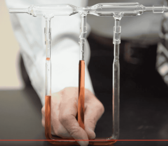

Here's a grab at 1:50 from the Bernoulli's Principle Demo: Venturi Tube video
It appears to show the air flowing from the viewer's right to left where the pressure in the third manometer appears to be higher than in the middle one.
Is there some complexity from the manometers being interconnected?
Water won't flow uphill. A gas will only flow from high to low pressure.
How can this be a correct interpretation?
That looks like a drop that is sticking to the side of the tubes. The level on the left is lower than the middle one. It is still a correct demonstration because the downward pressure in the middle tube is lower due to the air having higher velocity laterally in the constricted section.
I was referring not to the drop of water at the top of the third manometer, but the level of the top of the water column which is indeed lower than in the second column. Isn't the pressure indicated in the second manometer therefore lower than in the third one? Isn't the air moving from a lower pressure in the second one to a higher one in the third one. I don't understand how that can happen.

Yes, I suspect the manometers are measuring the static pressure and are not detecting the dynamic pressure of the moving air. But I still don't have the complete answer.

Where the pressure is lower, the liquid is higher in the vertical manometer tube.
There is a pressure drop across the central constriction.
You can see that from the height of the liquid column on the upstream side (right) and downstream side (left).
The manometer column in the middle shows that the pressure is lower in the central constriction, where the gas flows faster, than it is on either side, in the wide and so, slower flowing sections.

Yes, and that's what I am having trouble with. The pressure in the third chamber is higher than the pressure in the second, yet the gas is flowing from the second to the third: from low to high pressure. Most references claim that a gas only flows from high to low, but here it seems to be flowing from low to high.
It depends on how you number the chambers. We need clarity.
Flow is from right to left, so maybe you should number them from right to left.
The right-hand side = inlet-chamber has the lowest liquid level in its manometer tube, so the highest pressure is in that chamber.

There are only two chambers. The manometer tube in the middle is connected to the restriction between the two chambers.
The fluid velocity is higher in the restriction, so the static pressure there is lower.
Dynamic pressure is irrelevant here because the manometers, that read static pressure, are perpendicular to the flow direction.

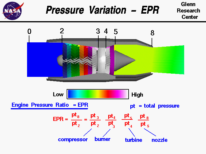

As for gas going from low pressure to high pressure, this is literally how an axial compressor works:
Note that there are no valves in an axial compressor to prevent the flow from going from the high-pressure zone to the low-pressure zone. Actually, the flow may be reversed in an axial compressor under certain conditions; this is known as compressor surge.
The term you might want to look for is adverse pressure gradient.
Compressors do work on the flow, so it's not a great example. But as I said earlier, all you need is to look at it in terms of ##F=ma##. Fluids can flow into higher pressure regions without any external work applied but they will slow down when doing so.

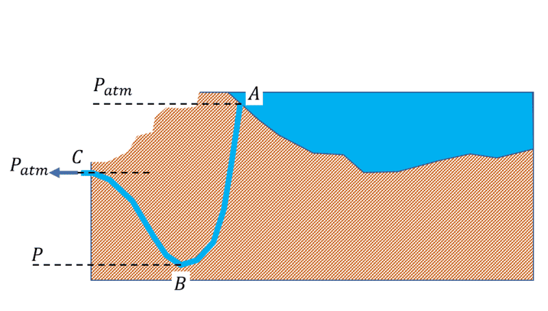

But anyhow, in an attempt to dispel the "useful common misunderstanding" that a flow will never go from lower pressure to a higher pressure...think about this:
Point ##A## is just below the surface of the reservoir, point ##C## is the discharge that is somewhere below point ##A##. There is a flow established in the pipe. Imagine manometer taps at ##A## and ##B## something should jump out at you about the flow not being able to go from low to high pressure?
Does water flow uphill? No, It won't do so in an open channel, but in a syphon, under capillary action or in a U-bend, water does indeed flow uphill.
In a gas turbine engine, or a desktop fan, air "flows" from Atmospheric pressure to the high pressure downstream of the blades.
Thanks @erobz and @jack action.
And in the video, the air does flow from the low pressure of chamber B to the high pressure of chamber C.
I guess the problem lies in the word "flow".

I am aware the syphon an U-bend examples involve the conversion of potential to kinetic energy, the gas turbine example has an energy input from the combusting fuel and the desktop fan is using electrical power.
This will take some more thinking about.

The explanation of how water flows upstream in a syphon is answered with simple mechanics: as long as the pressure in the water on the rising side is greater than its vapour pressure, the water will remain a liquid and gets pushed by air pressure over the hump. If the rise is more than 32 feet, then at the top of the hump the water will change form a liquid to a gas the water velocity will reduce to zero.
A similarly simple, basic physics explanation exists for the U-bend and a slightly more complicated one involving surface tension will explain the capillary action.
I still don't have an explanation in similarly basic physics for how the gas can flow from the low pressure of chamber B to the higher pressure chamber B, i.e. one that doesn't depend on the more advanced concepts behind the Bernoulli Principle and Euler's differential equations.

There is a similar effect to Bernoulli, but in an open channel, where water flows uphill in a hydraulic jump. That occurs when the fluid exchanges kinetic energy in a low-sectional-area channel, for potential energy in a higher-sectional-area channel. The water surface rises against gravity, under a fixed atmospheric surface pressure. Energy is conserved.
https://en.wikipedia.org/wiki/Hydraulic_jump
I was going to point out a more trivial example of water flowing "uphill":
Bernoulli's principle still mostly applies to/explains this.

Baluncore said:
You missed post #20.
Sure, that's true, even if it's a bit of a stretch to say that it "flows uphill". But the point has been accepted. Under some circumstances, water does indeed flow uphill.
Baluncore said:
A bicycle will not roll uphill, unless it rolls downhill gathering speed, across the floor of the valley, then rolls up a hill until it almost stops. There, kinetic energy is being traded for potential energy = m⋅g⋅h.
Gravity * height is the equivalent to the potential energy of pressure in Bernoulli's effect.
Again, no argument, this uphill flowing can be explained in simple physics terms of trading body's KE for PE.
My original claim that water doesn't flow uphill was too much of a generalisation. I'm sorry I mentioned it!
I'm still looking for a similarly simple physics explanation of how a gas flows from low to high pressure. I know it does, I just can't quite work out how.
