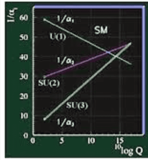

The strong force and electromagnetic force both change in strength with the momentum exchange present in the interaction (i.e. in high energy/high temperature interactions).
At high energies, the strong force gets weaker, and the electromagnetic force gets stronger.
The electromagnetic force coupling constant is about 1/137 at minimal energies, and about 1/127.5 at the Z boson mass (i.e. about 91.1876 GeV which is about 10.6 billion degrees Kelvin).

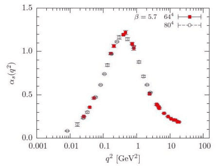

The chart below shows inverse of the strength of the three Standard Model forces with energy scale: U(1) corresponds to electromagnetism, SU(2) corresponds to the weak force, and SU(3) corresponds to the strong force (the strong force hits a peak and then gets weaker again at energy scales below those depicted in the first figure, as shown in the second figure).

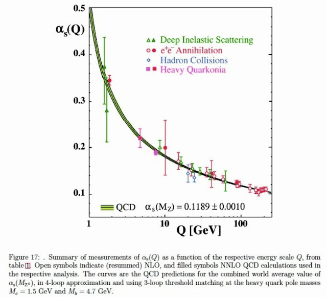

As shown here for the strong force:
The strong force coupling constant, which is 0.1184(7) at the Z boson mass, would be about 0.0969 at 730 GeV and about 0.0872 at 1460 GeV, in the Standard Model.
See also here and here.
