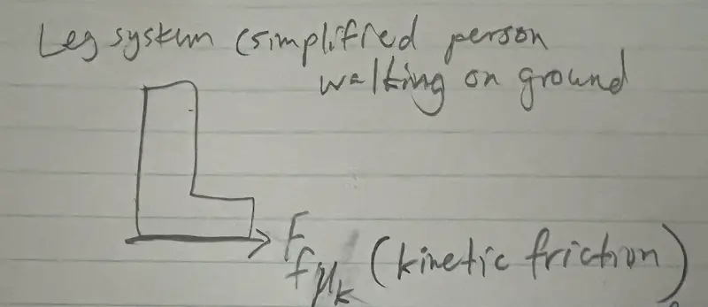

I know that static friction is what helps a person walk forward. I am wondering if the walking person still gets propelled forward if their foot slips and kinetic friction takes place
If we draw the free body diagram of a person walking with the feet slipping, we have kinetic friction applied to the feet. Is this kinetic friction going to propel the person forward? For example if the person tries to walk on ice, the foot just slips and the person doesn’t get propelled forward by the kinetic friction.

Ok, then how come with the free body diagram of this simplified system (a person slipping on the floor represented as just a foot in the image below), there seems to be only a forward force, the kinetic friction, propelling the foot forward, but the leg should be overall moving backward due to the slip?
Yes, kinetic friction is opposite to the relative motion of the slipping surfaces in contact. The foot can move backwards, while the center of mass of the body accelerates forward.
While one foot is sliding slowly backwards, the other is stepping a longer distance forward.
The work you are doing is the horizontal kinetic friction force, multiplied by the distance your foot slips backwards, generating heat. An equal force will accelerate your body.
What if the system is just for example a mechanical/electrical foot that moves and slips on the floor. As the foot pushes down and back on the ground, shouldn't the foot be slipping backwards, but according to the free body diagram, the foot should just be propelling forward due to the kinetic friction.

What do you mean by that? What exactly makes the "mechanical/electrical foot" slip on the floor? It's not clear what mechanism you have in mind. And if your "vehicle" has moving parts, then modeling it as one rigid block is eventually not useful for understating what's going on.
Velocity can be backwards, while net force and acceleration is forwards. But it's unclear if that's the case in the scenario you envision, because you have not defined it properly.

What I mean is that there is a mechanical foot that moves the same way a real foot moves but is powered electrically. The foot starts at zero velocity and then pushes down on the ground, causing the foot to slide backwards, but if we analyze the free body diagram of the foot, the foot should just be moving forward not backward due to the kinetic friction with the ground and because the force causing the foot to slide backward is an internal force. So why is this foot moving backwards not forwards?
Internal to what? If the force is applied to the foot by the leg, then it is external to the foot. You have to make up your mind, if you are analyzing just the foot, or the entire body.

I simplified a person walking into just an electro mechanical foot. The force is applied to the foot to move it due to a battery powering the foot — so internal force
annamal said:
The force is applied to the foot to move it...
Applied by what?
annamal said:
— so internal force
If it's applied "to the foot", then it is external to the foot, per definition.

The force applied to the foot is powered by a battery and motors.
The motor + battery + mecahnical foot I clumped together as the whole system.
The question wasn't where the energy comes from, but what object applies the force to the foot.
What is the motor moving relative to what? So far, your "mechanical foot" is completely ill-defined, and sounds like nonsense. Provide a clear diagram of that thing.
