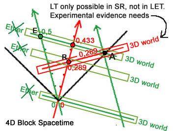

  • #37
Vandam said:
My diagram shows perfectly what LET means. In my diagram the ETHER frame is very well indicated. In that ether frame the primed coordinates do not make sense, unless they are mathematical fictous ad hoc numbers, just like Lorentz admited himself.
On the LET interpretation, the primed coordinates correspond to coordinate assignments that the moving observer would make. LET says that those assignments are not the "true" coordinates, but it still gives them a perfectly well-defined meaning.
Vandam said:
But apparently you can not give me the context in which the numbers make sense.
I already have, repeatedly. I just did it again, above. But you either can't understand or refuse to accept that LET is an *interpretation*, just as the "block universe" is an *interpretation*.
Vandam said:
Only if on that diagram red 3D spaces are added the coordinates make sense.
On your interpretation, perhaps. But there are other interpretations.
Vandam said:
We better stop arguing about this. It doesn't help either way.
I'll stop if you will.

DaleSpam said:
You have a serious obsession with solipsism. I am not a solipsist, if you believe that I have EVER made statements indicating that then please point them out and I will retract or explain them.
If you are not a solipsist, meaning you believe in an outside real world, then relativity of simultaneity leads automatically to Block universe.
What physical meaning? We talk physics on this forum.
No. observational evidence leads to block universe. See below.
DaleSpam said:
Do you agree that the common mathematical feature, the Lorentz transform, is what each uses to make all of its experimental predictions?
What are 'experimental predictions'? What is 'experimental evidence'?
Observation.
The LT matches what you observe. Indeed.
But what do you observe?
In order to observe an event (f.ex. a clock showing specific time indication), that event has to exist before you observe it and lightbeams travel from that event to your retinae. (If you refute this it is pointless to talk about 'observation'. What is left is only the image of an event you 'see' in your brain as a mental awareness with no cause or origin creating that image. Solipsism.)
Hence the experimental or observational evidence gives us information of that's going on in our 3D world. A 3D world that exists before you 'observe' any events of it, because we have to wait until the lightbeams reach our retinae.
The fact we do not know yet (now) what happens out there in our 3D world 'now' doesn't mean there are no specific events out there in 3D world.
What do the LT transformations tell us?
Green coordinates tell us that in the 3D world of Mr Green with wristwatch 0.5, event A is at .5 distance. The experimental/observational evidence for Green tells us that event A is simultaneous with his wristwatch .5 (event E), which means those two events are/were both part of one 3D world. (3D world = simultaneous events. Non-simultaneous events can never be part of one 3D world.)
The experimental/observational evidence for Red tells us that event A is simultaneous with event R, which means that they are/were both part of one physically real 3D world, a different one than Green's 3D world. That only makes sense in SR, not LET.
LT and the experimental/observational evidence shows that LET is wrong, but SR correct.
Of course you can say that the observational evidence is correct in LET if you consider red's observational evidence an illusion, a mathematical fiction. But is this physics? Lorentz knew the LT were problematic in his ether context. (I will not repeat his quote.)
Einstein's contribution was to solve that problem by changing the illusion into reality so to speak.
It means the relativity of simultaneity is not only a mathematical exercise on your calculator on the kitchen table, but a description of what is really happening with and in the real physical 3D worlds in 4D spacetime. Experimental and observational experiment (f.ex Einsteins train experiment) show us Block Universe.
