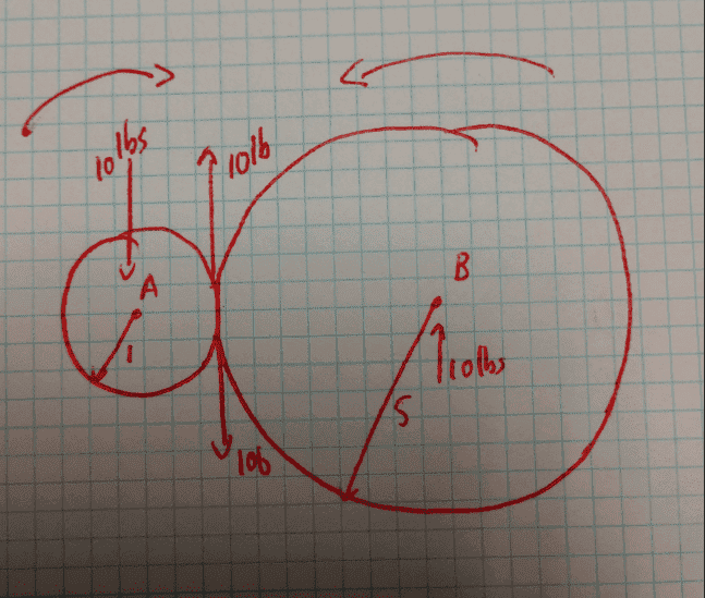

For example, let's say i have force acting on an object about some pivot. That object will apply an equal force about the same pivot, at equal lever arm, back. So there it seems like if the forces are in line, acting on the same pivot point, there is an equal and opposite torque.
However, if i have two gears, A and B, with A being half the diameter of B, as A drives gears B, there are contact forces between the gears and since there are different lever arms and point of rotations, the torques created are not equal.
SO i am wrong to say that N3L doesn't apply to torque?
Thanks for the clarification.

Okay i agree with that. But with that being said, if i compute the torque about a constant point, let's say the center of Gear A, then is there an equal torque about the center of gear A that equals the torque imparted to gear B?
I see a torque applied to Gear b, about its center, at its radius. So there has to be an equal torque to that then right?
Or back to my original question, does N3L not apply here to torque

I have done the math. Let's say A radius is 1. Let's say B radius is 5. IF we apply a torque of 10lb-inches to A and there is a contact force of 10 lbs between the gears, A has zero torque, B has 50 lb-inches. Where is the equal and opposite torque of B which has 50?

If you see the math over i did, gear B would feel a torque of 50 in lbs. How does this balance then relative to center of A
Again: it doesn't. You say you are trying to be consistent, but you aren't. I think it is because the thing you really want to do here breaks the consistency and isn't possible. You can't equate the torques around A and B in the way you are trying to.

Dale And Russ, can you confirm this? IF i sum the torque about A, i agree, but if i look for equal and opposite which is what started this thread than that's different.
Here is an example. Assume Gear A has radius 1, Gear B has radius 5. Gear A and B are mounted the Earth and there is a motor providing the 10lbs-inches of torque to gear B. Steady state, no acceleration of the system. No friction. Torque B requires leave A with zero, so its speed is constant

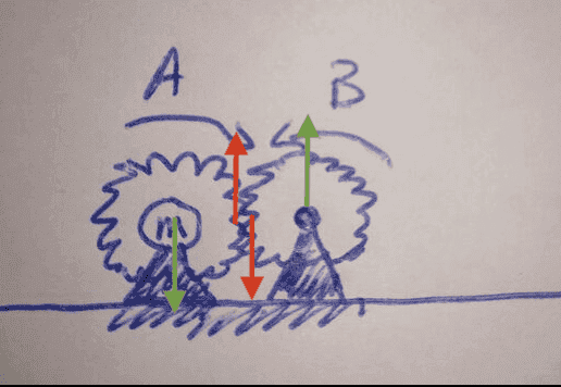

I provided a drawing. IF someone could mark up the 3 law pairs for torque on a two gear system i would be most greatful. I don't see my mistake and the sad face Imogi and tidbits are not helping me. I appreciate it, but if for every torque there should be an equal and opposite, then we cannot just ignore the torque on B

alkaspeltzar said:
You have 3 torque interactions here, and the N3 applies to each of them, when taken around the same point :
torque_by_GROUND_on_A = -torque_by_A_on_GROUND
torque_by_GROUND_on_B = -torque_by_B_on_GROUND
torque_by_B_on_A = -torque_by_A_on_B

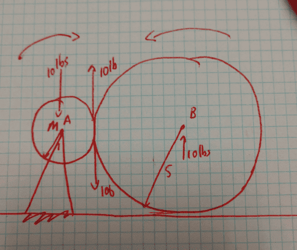

Here is the problem. A is the driver gear. It has a motor providing 10 inch lbs to it. B is the driven gear.
I see a 10 lb force acting at B, which is 5 away. THat is 50 inch lbs. Let's assume B is a wheel touching the ground

That's a different drawing and description from what you provided before. So just remove my edit: you need to tell us what gear B is connected to. A shaft? A wheel touching the ground? What? In order for the torques to sum to zero, there needs to be a second torque on gear B, opposing the torque applied by gear A.
You have 2 torque interactions here, and the N3 applies to each of them, when taken around the same point :
torque_by_MOTOR_on_A = -torque_by_A_on_MOTOR
