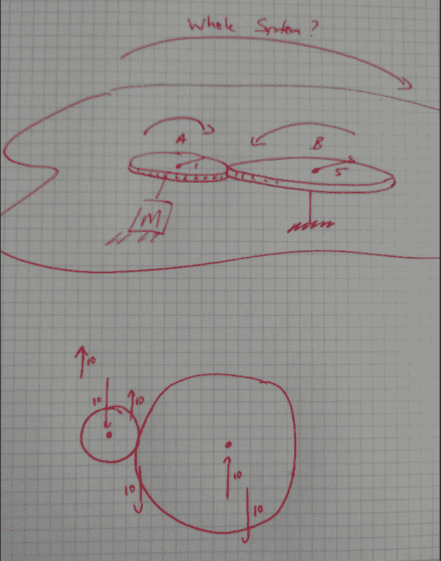

Russ, i have edited my picture to show A is connected to a Motor, on the ground. And B is a wheel touching the ground.
So, the ground a applies a torque around B, equal and opposite of what gear A applies.

The vector torque is an axial vector. To uniquely define a torque on an extended body one must specify the axis (or equivalently the point of application) of the torque. Within this definition a strong form of Newton's 3rd Law Rotational applies: there is an equal and opposite torque at the same point of application (or along the exact same axis equivalently) from the torquee to the torquer.
The equivalent Newtons Law for forces also tacitly assumes the line of action of the forces is coincident.
The case listed above is not correctly analyzed by the Newton 3rd rotational law because the axes are not coincident.

So I asked that at the beginning of my post. N3l for torques only applies if the forces are inline and act at the same point, THerfore same radius.
So with these gears, yes Ang. Momentum must still be conserved, but I cannot say there is a n3l for torques

I have been asking where does the 50 inch lbs torque about B get balanced out.

I think I'm understand. I cannot compare torque at B since we have to maintain being consistent with A right? That's what I am looking to confirm.
So we look at torques about A and only A, everything balances correct?
Perok that's what I'm trying to get. I am really trying. Not trying to be pig headed

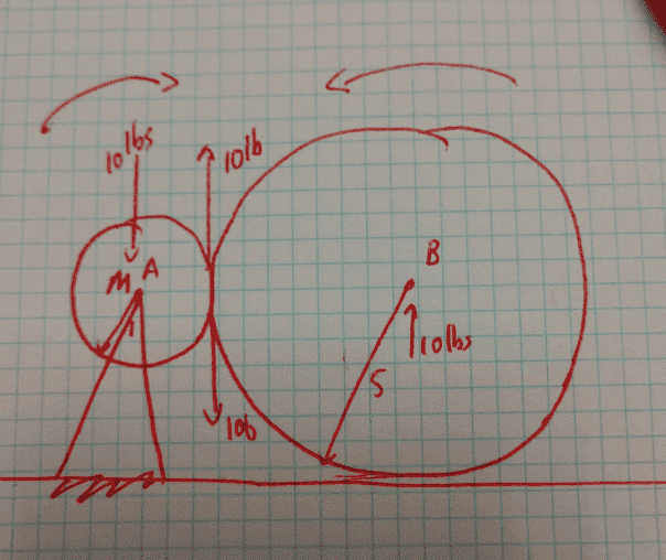

Here:
torque_by_GROUND_on_B = -torque_by_A_on_B = 50

So the ground applies a horizontal force of 10lbs at the 5 inches about B. This is opposite and equal to the torque by A on B, about B. ANd if you consider gear B, these are the opposite and equal torques for it. Its like Gear A is now acting similar to the ground, and therefore the N3L balance.
Right?
Right?
Sounds about right, yes.

I think i see what is going on here. In the end, torque is dependent on the point of rotation and everything about it, like summing the moments has to be done around the same axis. However, because of conservation of ang momentum, and N3L, it all has to balance one way or another.
This example probably was bad as i didn't start with good unknowns, but in the end i see it all. Makes me understand why in many cases we don't have to care about all the reactions because we identify our system to make life easier.

Wrong. The torque_by_A_on_B and the torque_by_GROUND_on_B are not a N3L pair. This is not N3L, but a N2L balance. You are still confusing the laws you are applying.

I have given you all the N3L pairs, for all your diagrams. Nowhere in there are torque_by_A_on_B and torque_by_GROUND_on_B a N3L pair.

No, you don't ignore what is happening to gear B. You must include all torques on all objects in the system. But you must fix the axis of interest. Which axis do you want to know if there is torque about? Then you calculate all torques about that point.

"About B" makes no sense. Do you mean about the center of B? You can use any point, as long it's the same for both torques of an N3L pair.

i want to know the torques about the center of A

Then why do you keep asking about the torques "about B". Are you confusing "torque about ..." and "torque on ..."?
