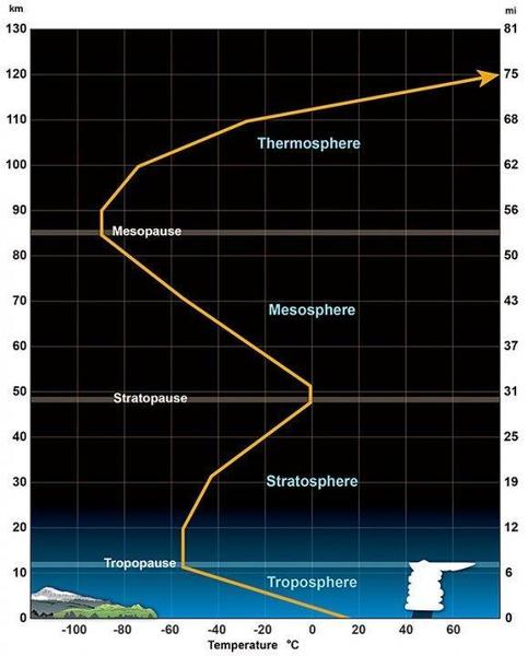

atmospheric temperature profile is very well known and if it had anything to do with gravity, a profile like this wouldn't be possible...
note the dramatic positive and negative temperature swings with altitude !
source ...
http://www.srh.noaa.gov/jetstream/atmos/atmprofile.htm cheers

Dave,
Does that diagram hold true at night?
Night/Day makes little difference to avarage atmosphere temperature.
It does have noticable effect, but nothing very dramatic.

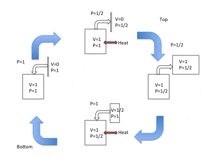

The last week I've been daydreaming something that looks very similar to the below, trying to get my head around all this:
I think its time to return to daydreaming about a Ducati I've been saving for, yet I don't think I will able to until this is all put to bed.
For the sake of my sanity, can someone please why this isothermal elevator doesn't work! :confused:

Could you please also explain why https://medium.com/criminal-clouds/the-isothermal-elevator-part-3-of-3-7d828edb3c1a wouldn't work?
I think I would have to look closer, but at a glance it looks like they leave out a lot of work. You can fill up a tank with sea level air, and fly it in a plane to high altitude, and extract the energy from the pressure difference, but you use a lot of energy in raising the container.
I would guess that including the process of pumping a vacuum in the cylinder would stop the process from being free. Same as it takes energy to fly that tank to a high altitude, you cannot get it very high without an energy expenditure.
Further, you know how the atmosphere supports a column of mercury 760 mm high, or a column of water about 30 feet high? There is a limit to how high any particular mass can be lifted. Even if the mass was just the mass of the air and the tank was weightless, there is still a thing being lifted. And that air would not actually be lifted all the way to the top by a vacuum. The perfect vacuum would only lift a (weightless) tank of air at the lower mass of the upper altitude air, to the top. It would not lift a (weightless) tank of air at the lower pressure, because it weighs more.
To me it looks like they are leaving out the fact that the tank will never get lifted that high by a vacuum, and that it takes energy to make that vacuum. I rather suspect that it is a huge waste of energy overall.
If that is all completely wrong, feel free to tell me. I formed that opinion without a detailed reading.
Best to have a closer read votingmachine,
The gas containing vessel is lifted by a pulley inside an elevator shaft. I'm guessing that the elevator shaft is a vacuum so buoyancy doesn't have to be factored in, not to actually conduct the work. Because of this, I'm actually quite confident on the vessel lifting calculations being correct. The calculations are just a combination of the ideal gas law and gravitational potential energy formulas. They are so straightforward I expect high-school students to be able to do the calculations.
The isothermal expansion formulas are far more complex. I'm thinking that they must be out by a factor of 2. If the expansions only produced half the energy then there would be no net energy production. This is what I would expect from anything that has been idealised, so that friction and other inefficiencies are not factored in.
My bad. On closer reading I see the raising and lowering hoist. I thought the picture showed a piston. And I agree that the bouyancy is probably why they specify a vacuum.
I don't see any math errors. It looks to me like that is a process for extracting energy from a higher pressure gas to a lower pressure gas. It does seem a bit surprising that there is an energy net. But it is not impossible, not a violation of perpetual motion. I think the temperature issue would be the reason it breaks down. I think it is more like one of those "drinking bird heat engines". It postulates that you will expand the ground temperature air into the low pressure high altitude air, in an isothermal expansion. You can do that once, but the next time, the air is a little cooler. eventually you extract enough heat from the high altitude air, that there is no more isothermal expansion.
It is possible that this is another basis for the temperature drop in the air with altitude. I can't quite reason that out, but this process for extracting work if the temperatures are the same suggests that the work would instantly be done by the unrestrained atmosphere.
If you put in a T1 and a T2 for the top and bottom temperatures the work changes. From a quick google ... the summit of Mt Everest runs between -20 C and -35 C. Call that 250 and 235 K. If you used Hawaii, Mauna Kea is 13,000 feet high and the summit looks to be about 40F (275K) when the sea level is about 80F (300K). Summit pressure is about 0.6 atmospheric.
The work on the up and down cycles also changes a slight bit. The colder air at the top is more atoms at that pressure ... a bit more mass. And the air you raise up is warmer ... a bit less mass. That is beneficial.
Interesting read, and other than the temperature bit, the math doesn't appear to be in error. I still put it as similar to the "drinking bird heat engine". And since the requirement is for a pretty substantial amount of infrastructure that has to be extraordinarily efficient ... I can't see anyone really testing this out. Perhaps taking a bottle up and down Mauna Kea would be a great research grant to try and get. I volunteer to surf out and get the cleanest ocean air for you. You can walk to the summit and back down, then I will get the good stuff from a wave. Heck, put TWO bottles in the grant. I'll fill 'em both.

The work of the total process is zero. The calculation in the link results in a net energy production because W2 and W4 do not include the volumetric work done by pushing the air out of the vessel or into the vessel. They just cover the expansion or compression and are therefore be valid in an evacuated environment only only.
I'm not following that work. The air moves from high pressure to low pressure. The work is taken when the environmental, sea-level atmospheric pressure pushes air into the (high altitude, low pressure) vessel, and again when the (sea level pressure) vessel is allowed to push air out, into the high altitude, low pressure environment.
Where/what is the volume work?
For a better understanding let's divide step 2 into two separate sub-steps:
In step 2a the air in the vessel expands from bottom pressure to top pressure. This process releases energy. But now there is an excess volume that does not fit into the vessel and needs to be released into the environment. As there already is air that needs to be pushed away, this process consumes energy. Therefore only a part of the energy released during the expansion remains inside the system. The other part is gone with the volumetric work done against the environmental pressure. Step 4 can be divided in a similar way.
Here is my calculation:
With a bottom pressure p1 the top pressure is
[itex]p_2 = p_1 \cdot \exp \left( { - \frac{{M \cdot g \cdot h}}{{R \cdot T}}} \right): = p_1 \cdot \exp \left( { - k} \right)[/itex]
All processes are assumed to be isothermal and reversible.
The vessel has the volume V1 and its empty weight shall be compensated by a counter weight. Thus moving the empty chamber requires no work.
Step 1: Lifting
[itex]W_1 = - m \cdot g \cdot h = - n \cdot M \cdot g \cdot h = - p_1 \cdot V_1 \cdot \frac{{M \cdot g \cdot h}}{{R \cdot T}} = - p_1 \cdot V_1 \cdot k[/itex]
Hi DrStupid,
I'm very glad someone is having a go at this. I'm not sure I'm reading you correctly, but I am pretty sure the vessel does not expand. I think its quite clear that the energy is harnessed from air moving through expanders that are stuck to side of the elevator shaft. There is no volume to be expelled.
I could easily be misunderstanding you so please elaborate.
  • #32
I think that is not quite the set up they describe. The vessel is a fixed volume. The vessel is attached at the bottom for "filling", then detached, and attached again at the top for "emptying". I follow the math, but the intuitive sentence for step 2b and 4b elude me.
I still half-think there is a heat engine going on. As a mental image, picture a box with a gossamer divider. Say the top pressure is 0.5 atmospheres and the bottom is 1.0. The divider is at the end of the box and the air inside is at 0.5. At the bottom, the expanding 1.0 atmosphere air moves the divider to 1/2 the volume, and fills the other side. That makes the box full of 1 atmosphere air. Then at the top the divider slides to the end again, as the air expands.
At the bottom, the isothermal expansion absorbs heat, to keep the temperature constant as 1.0 atmosphere air expands, which would ordinarily cool. At the top the expanding gas again absorbs heat. To have an isothermal expansion, heat has to be added.
I'm not sure that the answer cannot be non-zero. It seems like it ought to be zero. But if it is not I think the heat flow explains it.
  • #33
It IS a heat engine in a guise where the external heat added that drives a delta-P (to do work) is subsituted for gravity driving the delta-P.
So the true question is can we harness gravity like this? I am questioning all the idealised elements of the elevator.
I suspect the 2nd law of thermodynamics isn't really in jeopardy.
  • #34
You need to push the outside air away. The usual formula for the work gained from isothermal expansion, assumes that the gas is in a cylinder pushing against a piston with vacuum on the other side. If there's air on the other side, you need to do work to push it away.
Note however that the work on the outside air at the top and at the bottom cancel, so you could just ignore this.
So you could have a process that takes or produces no work and cools the whole elevator?
The expansion at the top produces work and removes heat, and the compression at the bottom takes work and removes heat. This is only OK as long as there is no temperature difference, since otherwise the 2nd law would be violated. In the real atmosphere, the elevator would take work, cool the top and heat the bottom more.
The problem with the calculations on the Isothermal Elevator page is in
[tex] W_{exp} = \Delta nRT ln (\frac {P_{final}}{P_{start}}) [/tex]
used in the calculation for the expansion or compression of gas.
I don't know where he gets the Δn from.
Wexp=ΔnRTln(PfinalPstart)​
Yes,you must be right. So if that is the wrong formula, what is the right formula for the process?
