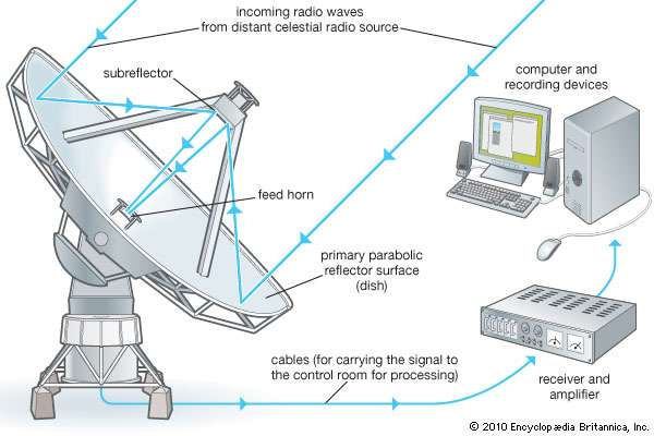

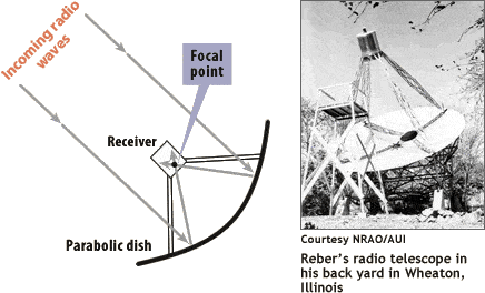

A radio telescope dish? Geometric "optics" is probably pretty decent for that application (even if you then make your telescope part of a synthetic aperture telescope). But generally "rays" are useful concepts when wave-y effects like interference and diffraction are negligible - which is pretty often not the case for radio waves.
Likes Dr_Nate, berkeman and kent davidge
