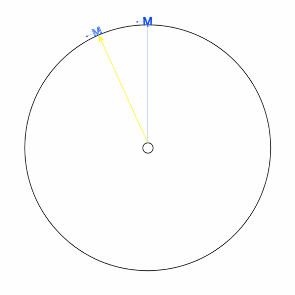

A spaceship named "Marcela" circle kilometers (maybe about 129e6 km) away at 0.5c.
It has synchronized its time of orbit with IS that it sees it all the time at the same position and distance.
What is the speed of Marcela relative to IS and how the optic clocks explain this time dilation ?
Here you have postulated a spacecraft which is still moving at 0.5c relative to earth. You have varied its orbital radius so that it remains directly above the ISS at all times (this seems to assume that the ISS is in an equatorial orbit -- which it is not). You proceed to ask about its speed relative to the ISS.
The answer is obviously 0.5c. The velocity of the ISS is negligible compared to 0.5c. So the velocity of the 0.5c orbiter is still 0.5c in any inertial frame where the ISS is momentarily at rest, just as it is in an Earth-centered inertial frame.
However, there is a potential ambiguity. You have said that "it sees it all the time at the same position and distance". This suggests that you are adopting a frame of reference that rotates with the orbit of the ISS. In this reference frame, you have stipulated that Marcela is motionless.
The answer now is obviously 0.
But changing the reference frame does not change anything about the situation. The time dilation formula based on an object moving in an inertial frame still applies. The fast orbiter is still moving at 0.5c and its time dilation is the same as before.
  • #52
Steeve Leaf said:
This is the speed to calculate time dilation. see Marcela question to understand my point.
There compare to the ISS 0.5c Marcela got 0 relative speed and no time dilation.
If you understand my point and think that i am wrong please explain.
It is definitely out of my league I knew it before looking back into it ☺
Just because Marcela and the ISS do not have a relative motion as measured from their rotating frame, does not mean that there is not going to be no time dilation between them. This is due to the fact that they are viewing each other from a non-inertial rotating frame.
Earlier I advised you to forgo these types of non-inertial scenarios until you had come to grips with inertial motion scenarios. The above is an example of what I was talking about. You came to an incorrect conclusion by trying to analyze a situation you weren't ready to deal with.
The easiest way to analyze the Marcela-ISS scenario is to first look at it from the inertial frame which does not rotate with the pair, and then transform that into what the pair will see. First we will consider a signal transmitted from ISS to to Marcela. For ease of explanation, we will assume a tight beam transmission.
The following image will help in illustrating the scenario.
The small circle is the ISS path and the larger one is for Marcela. The blue line joins the ISS and Marcela. If the ISS wants to transmit a signal to Marcela, it can't just point along the blue line. Because in the time it takes for the Signal to travel from the inner circle to the outer one, Marcela (the solid M) will have maoved to the Position shown by the Outline M, and the signal would miss the target. Instead the ISS has to "lead" Marcella and aim for where Marcella will be when the signal arrives.
The other thing we have to note that the signal. traveling outward at c meets Marcela at a right angle to Marcela's own 0.5c. This means that the Closing speed between Marcela and the signal will, in this frame be greater than c. Thus the momentum involved in their meeting will be greater than if the closing speed had been just c.
If we jump to what Marcela detects, the signal will appear to come from some where a bit ahead of it in the direction of its motion. Since it will measure the signal arriving at c, the extra momentum will be seen as an increase in frequency, or Doppler shift, of the incoming signal at a rate of ~1.155
Thus if the ISS sent a ten second message at 100 khz, this represents 1 million waves transmitted. Marcella will receive the signal at 115.5 khz and thus get those same 1 million waves in just 8.66 seconds. He will see things happening on the ISS as happening 1.155 times faster.
Next we consider a signal sent from Marcela to the ISS:
Again, if Marcela trys to send a signal to the ISS by pointing it antenna towards the ISS, the signal will actually follow the path shown by the dotted line*. This is similar to what is shown in the earlier light clock example where the light travels at a diagonal as seen by someone watching the clock pass by. In order to get the signal to travel along the solid yellow arrow, Marcela actually has to aim its antenna in the direction indicated by the orange arrow. Since this points somewhat in the opposite direction of Marcella's direction of motion, this subtracts momentum from the signal.
Again the ISS measures the signal as coming in at c, and thus measures this as a decrease in frequency of 0.866. If Marcella sends a 10 sec message at 100 khz, the ISS will receive those 1000,000 waves making up the signal over 11.55 sec. The ISS sees everything occurring on Marcella as happening 0.866 as fast as it does for itself.
Now since neither the ISS or Marcella measure the distance between themselves as changing, they can not attribute any of the Doppler shift they see as being due to a change in propagation delay and can only put it down to events actually running faster for the ISS than they do on Marcella.
Changing the distance at which Marcela circles at 0.5c will complicate the signal analysis some, but will not change the degree of time dilation between the two.
*This also happens with the ISS, but since the speed at which it travels is so small compared to the speed of light, the difference between the direction of aim and the actual light path direction will be extremely small. It does have a small effect of the measured time dilation, but it is only the difference between the time dilation factor at 0.5c and at 4.99974c.

  • #55

  • #59
Thanks,
ISS got a clock on it , it send a tv signal of this clock to M which broadcast it with no delay back to ISS monitor.
Now at ISS we can see the actual watch and the tv image after the round journey.
Why the difference between the actual clock and the monitor clock will change and not stay the same if
1. the distance stays the same.
2. The change in frequency don't change the time the signal travel.
3.This is ISS own clock.
4. No looking through telescope.
The difference is the time it takes to cover the unchanged distance.
Where the complication occur ?.☺
  • #60
Steeve Leaf said:
Thanks,
A hypothetical technician on M would see a high frequency carrier wave encoding a high speed video. As I understand the scenario, the high speed video is rebroadcast on a normal (according to M) frequency carrier wave.
Back on ISS, we would receive a low frequency carrier wave encoding a normal speed video. What would lead you to expect otherwise?
  • #61
Ahaha , That is the big question. you got it , that is my problem Doctor !
The man on M will he see the tv clock moving at faster rate than his own because of time dilation on M , but because the signal doesn't delay at M at all this dilation don't appear on ISS TV.
Any delay on M will affect the tv on iss with dilation.
Am I correct ?
  • #62
Steeve Leaf said:
Thanks,
There won't be a difference between The ISS local clock and the TV image on the ISS monitor.
To illustrate why this is, we will consider a 10 second message again. The ISS send a message that is 10 seconds long. Remember from my last discussion, Marcella will receive this message over a period of 8.66 sec. If it immediately rebroadcasts this message just as it received it, it will transmit a 8.66 sec long message. You will also remember that the ISS would receive a signal from Marcela over a time period 1.155 times longer that of the length of the message sent by Marcela. Thus is Marcela sends a 8.66 sec message at its end, the ISS receives a 10 second message at its end.
The ISS sends out a 10 sec message and gets a 10 sec message echoed back.
