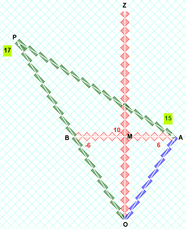

This spacetime diagram on rotated graph paper might help.
I will use more arithmetically-convenient numbers.
In the lab frame,
the green observer moves to the left at (6/10)c, and
the blue observer moves to the right at (6/10)c.
And these observers separate with separation rate at (12/10)c=(1.2 light-years/yr) in the lab frame,
the rate (according to the lab) of relative-displacement of blue observer from the green observer per unit lab time.
But in the green frame,
the blue observer moves to the right with relative-velocity at (15/17)c=(0.8824 light-years/yr),
the slope of the blue worldline according to the green observer (which must be less than the speed of light).
The spacelike displacement PA is purely spatial according to the green observer, along OP.
[That is, P (the 17th tick according to the green observer) and the distant event A on the blue worldline are simultaneous according to the green observer.
[itex] \begin{align*}
v_{AB}
&= \frac{v_{AL} - v_{BL}}{1- v_{AL} v_{BL}/c^2} \\
&= \frac{(6/10)c - (-6/10)c}{1- (6/10)(-6/10)} \\
&= \frac{15}{17}c \\
\end{align*} [/itex]

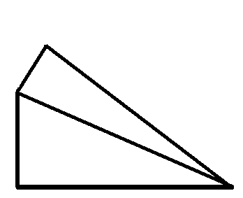

Try this. I've replaced "velocity" by signed-slope, etc...
I think this has been my difficulty.
It is difficult for me to grasp how the signed-slope of line A is not a fixed perpendicular-displacement per radial distance in all orientations of axes.
It seems instead, it varies according to which radial line is used as a reference.
Thus line A is angled away from line B at a different signed-slope to the signed-slope of line A angled away from line I.
Line B seems to be angled at a perpendicular-displacement per radial distance depending on which radial line is used as a reference.
And this is weird.
So line A and line I observe different signed-slopes.
Can we then say that both line B and line I are both valid in measuring signed-slopes ?
Because this means there is no such thing as fixed signed-slope , but only signed-slope with respect to a given line .
Weird.

  • #32
YouAreAwesome said:
If I am watching a car travel towards me and I run towards it our combined velocity will be equal to the velocity I experience from my frame of reference.
Yes, but the way you combine them is not by adding them. This is analogous to stacking a pair of wedges. You set the first wedge on a level table top and measure the angle that the upper surface of the wedge makes with the table top. You also measure the slope of that upper surface. Now you stack a second wedge on top of the first wedge in such a way that the upper surface of the second wedge forms a steeper slope. You can add the angles of the wedges to get the angle of the upper surface. But you cannot add the slopes to get the slope of the upper surface. However, if the slopes are small adding them gives a good approximation. Likewise, adding speeds gives a good approximation when the speeds are slow.
My movement in the spaceship towards the light does not add or subtract velocity from the speed of the light in the way my running towards a car increases the combined velocity.
We would use the same formula in both cases.
But from inside the spaceship the light would still appear to be traveling at the same speed, it would not appear to be traveling at the combined velocity of c plus the spaceship velocity.
Yes it would, provided that you combine them properly. Adding them is not the correct way to combine them.
The fact the light hits the spaceship more quickly is the strange part.
But it doesn't hit it more quickly. The flashes of light arrive more frequently because they are closer together.
If you have a continuous beam of light (instead of flashes) then you note that the crests of the light wave arrive more frequently because they are closer together, not because they move at a higher speed.
Likes YouAreAwesome
  • #33
With the triangles you have shown, where is distance, time and velocity? What do the angles in the triangles represent? Is tan of the angle the velocity, the opposite side the distance and the adjacent side time?
  • #34
It is a Euclidean analogy to a Minkowsky geometry.
An acceleration in Minkowski space corresponds to a rotation in Euclidean space.
The origin for the drawing it the common vertex on the right.
You have the original trajectory (the lower line) which is a time elapsed horizontally (horizontal = time) and a certain distance vertically (vertical = space).
You have the the first change in velocity. (the lower triangle). You have an additional distance moved (the vertical line on the left). This takes place over the original horizontal time line. This yields a new trajectory (the diagonal line on the lower triangle).
Now you reset your frame of reference so that this diagonal line is your new baseline trajectory. It is your new horizontal time line. Its "horizontal" length is elapsed time. The "vertical" distance moved is zero. This new baseline is at zero velocity.
The next short segment on the left is a displacement in this new frame. Over the duration of the trajectory some object moves that much distance. Its trajectory is the long upper diagonal line in the upper triangle. You can read this trajectory as distance in the original frame versus time in the original frame. Or you can rotate your point of view and read it as distance in the second frame versus time in the second frame.
Likes YouAreAwesome
