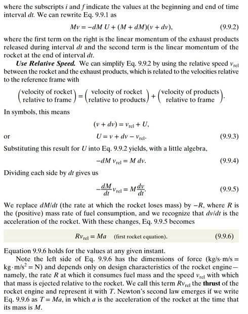

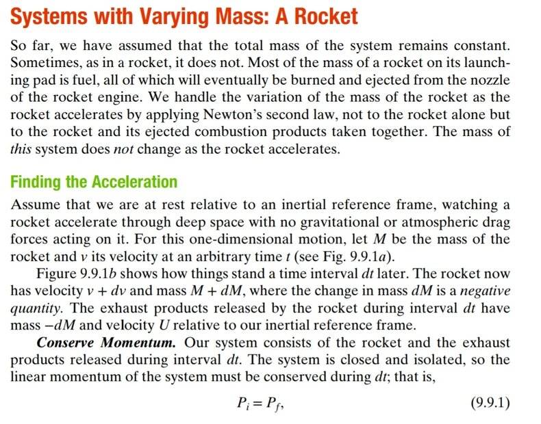

Anyway, I will attach the part of the text where the derivation in the OP is made.
Hak said:
Thank you very much. But, for example, one of the objections in the threads you referred me to is that the mass does not change in such a way that one can make a derivation with respect to time and that, therefore, such a statement is inaccurate.

Thank you very much. I'm attaching the derivation by Halliday: looking at it again, it looks slightly different from what I wrote, I don't know why. Some time ago I must have taken notes from the Halliday textbook and reworked it according to my version. I don't know what to say. What could you tell me? Do you have any advice or suggestions for correcting mistakes and thinning out my doubts? Thank you very much.
I can't read it.
erobz said:
I can't read it.

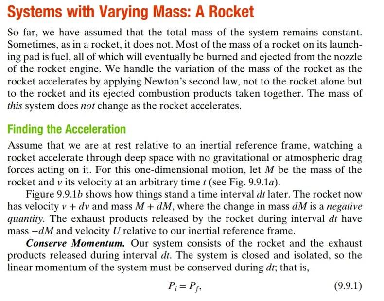

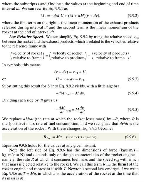

Thanks for the feedback. How about now?
Hak said:
Thanks for the feedback. How about now? View attachment 334604View attachment 334605
Good, none of this derivation is bothering in my opinion, it’s almost exactly what I did just without the presence of external forces. What is bothering you about it?

1) The role of ##u##. i.e. the question in post #1.
2) Where did ##M - \Delta M## come from in the OP? Quite a mystery, this is the document I had taken the demonstration from, who knows what I had in mind then. This is the other problem.
Thank you.
Thank you.
The derivation in post 1 is not the derivation you said it was. Just forget it. What don’t you understand about the correct derivation?

Hak said:
OK, thanks. Were you able to see the posts in the thread I referred you to in post #26?
Yeah, I see them, but we already covered that mistake I thought. The OP thought (##M+dM## ) was wrong because it looks like you are adding "very small" mass ##dM##, but in fact what we are adding is a "very small" negative change in mass in that expression. Then in the system that is gaining mass, we force that it gets the opposite of that change.
Likes Hak
  • #31
The OP in that thread is guilty of setting up the reader for confusion.
First the OP says "The rocket now has velocity v+dv and mass M+dM, where the change in mass dM is a negative quantity.". That's fine.
Then the OP says "If I'm allowed to change M+dM with M-dM and -dM with dM then Eq. 9-38 becomes
M * v = dM * U + (M - dM) * (v + dv)"
Equation 9.38 is
M * v = -dM * U + (M + dM) * (v + dv) ... (9-38)
Well, having defined dM as a negative quantity, one is not allowed to change dM to -dM but to -|dM| to avoid conflict with the definition plus confusion about the variables. Then Eq. 9-38 should be
M * v = |dM| * U + (M - |dM|) * (v + dv) ... (9-38a)
OP writes the equation
M * v = dM * U + (M - dM) * (v + dv) ... (9.38b)
Do you see the difference between equations (9.38a) and (9.38b)? They are the same but only if dM in (9.39b) is defined as a positive quantity which is in direct contradiction to its original definition. Is that what confused you?
The equation $$m~\frac{dv}{dt}=(u-v)\frac{dm}{dt}$$ gets around the issue whether ##dm## is positive or negative. The mass transfer to or from the system of interest 1 (e.g the rocket) and the secondary system 2 (e.g. the fuel) is such that ##dm_1+dm_2=0.## Study the derivation in the insight. Which one is positive and which one is negative is irrelevant. In the equation ##m## and ##dm## are ##m_1## and ##dm_1## with the subscripts dropped as explained in the derivation.
