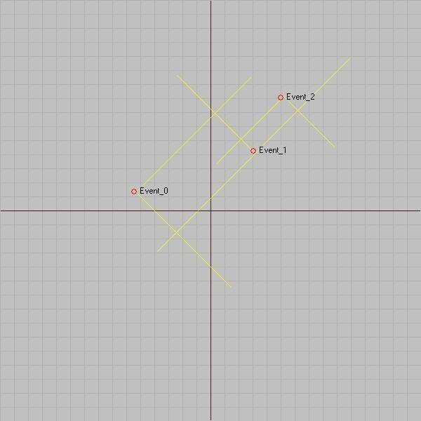

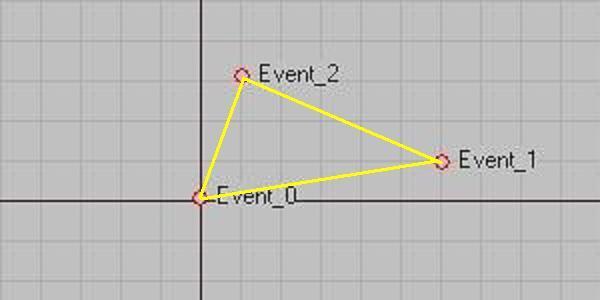

I think for you to understand all the answers here (Nugatory, Vitro and PeterDonnis), you have to understand what "space like" and time like" mean. And also space time diagram.
Two events are called "space like" when light can't go to that place in the speed of light.
Event_0: Goa, at time: 0 seconds
Event_1: Jakarta, at time: 10 miliseconds after Event_0
Event_2: New Delhi, at time: 20 milliseconds after Even_0
For example. the distance between Jakarta and New Delphi is (very close to)5000 km (ignoring the Earth curvature). It takes 16.7 miliseconds for light to reach New Delphi and Jakarta. So if there's an Event_2 happens at New Delhi at 20 seconds and Event_1 happens at Jakarta 10 miliseconds, we called the two events are space like. Light from New Delhi can't reach Jakarta at 10 miliseconds.
Event_0 from Goa and Event_2 from Delhi we call them time like. The distance between Goa and New Delhi is 1500 km, it takes 5 miliseconds for light to travel from Goa to Delhi. So Event_0 and Event_2 are timelike. Here the summary.
Event_0 and Event_1: space like
Event_0 and Event_2: time like
Event_1 and Event_2: space like
See the graph. The angle for space like event is less than 450. Time like angle more than 450
The space time diagram that I upload contains 1 spatial dimension, and 1 time dimension.

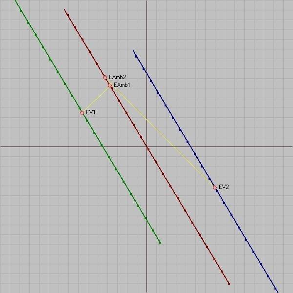

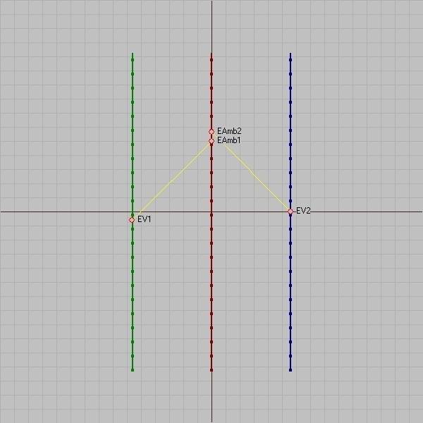

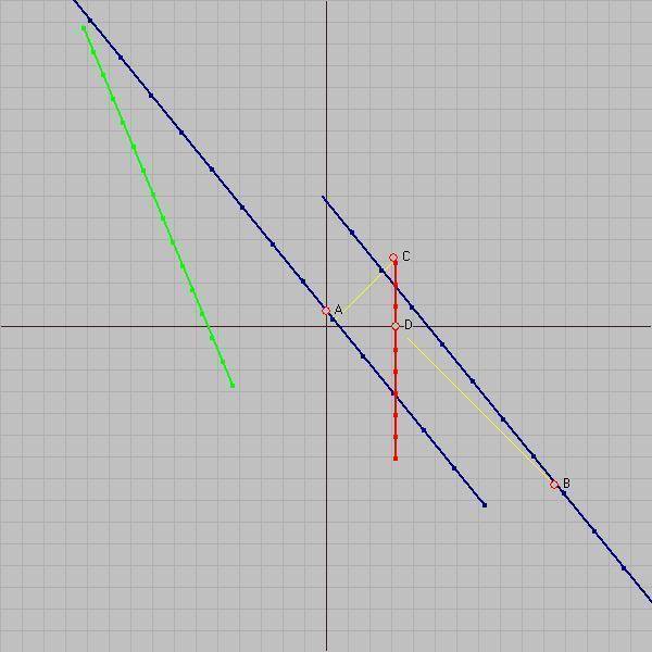

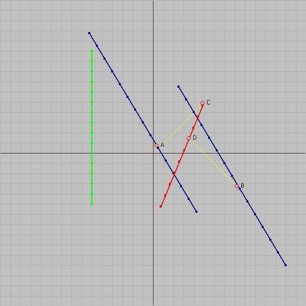

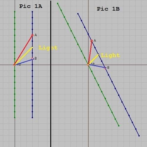

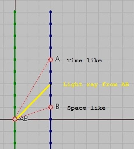

I think it's better to draw space time diagram for these events:
Pic 1 as seen from the victim A and B
Pic 2 as seen from other observer (Green) not related with the ambulance and the victims.

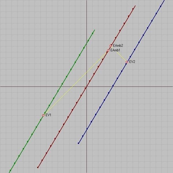

Pic 3 as seen from the ambulance:
Rohit Solanki said:
[..]If you see our above discussion, Peter and Orodruin suggested that events C(ambulance receiving call from A) and D(ambulance receiving signal from B) are causally connected. (And Peter I'd like your thought on the following point...)
Now I beg to differ here.
Altough events C and D are time like. Altough mathematically (and physically posible) correct that event D happens first after event C. We all both know that the phone call at event C doesn't trigger the phone call at event D.
The phone call from C is triggered by A and the phone call from D is triggered by B.
According to real world scenario
A and C is causally connected
B and D is causally connected
According to physics:
A and C are time like, so A can trigger C
B and D are time like, so B can trigger D
D and C are time like, so D can trigger C altough it's illogical one phone call triggers another! :smile:
A and B might/might not be time like. But as the pictures that I uploaded suggest: A and B are not time like they are space like
Rohit Solanki said:
Two events are causally connected when one event causes the other to happen.
Of course, that goes without saying. And that also implies that the events are time like.
Rohit Solanki said:
The logic behind the invariance of order of happening of events which are causally connected is that cause comes before effect.So if one event causes or affects happening of other event then the latter must always happen after the former. In the above case events B or D does not cause event C to happen or A or C does not have a role in cause of D. The effects of events C and D(where ambulance goes to, as it cannot be at A and B at the same time) are however connected. So while the effects of events C and D are related but C and D are not causally connected and hence the order of C and D should not be invariant.[..]
Now I think it's not right. Because event C and D happens at the ambulance call center if I might say. So C and D are time like, so C and D must be invariant. Altough A and B might vary, depending on the reference frame. See the picture for blue, green and red.
  • #34
Nugatory said:
If the two signals are received at the same place (the call center) at the same time, then their reception is a single event
I don't get how you clubbed two distinct events into a single event just because they happened at the same place and time. If we had established that both phones would ring simultaneously in all reference frames, then the worldline of the center would be timelike and all observers would agree that the event(both phones rang simultaneously) happened after 23:59 and before 00:01. But we didn't establish that the events would happen simultaneously in all reference frames.
To be more clear, suppose in the traincar experiment signals are sent from either ends of the traincar towards a sensor present in the middle of the traincar just as the train passes a platform. Then by relativity of simultaneity for the observer in the traincar the sensor would receive the two signals at the same place at the same time(simultaneously) while for the observer standing on the platform the reception of the two signals(two different events) would happen at the same place but at different time.
So just because two events happened at same place and time in one frame, I don't think it makes them a single event or consider it timelike and declare that all observers would agree that two events always happen at the same place and same time.
PS: I apologize for the confusion caused by the poor example of the spaceship. Events A and B are to be spacelike separated. Right now I am thinking of a better example to illustrate my point
