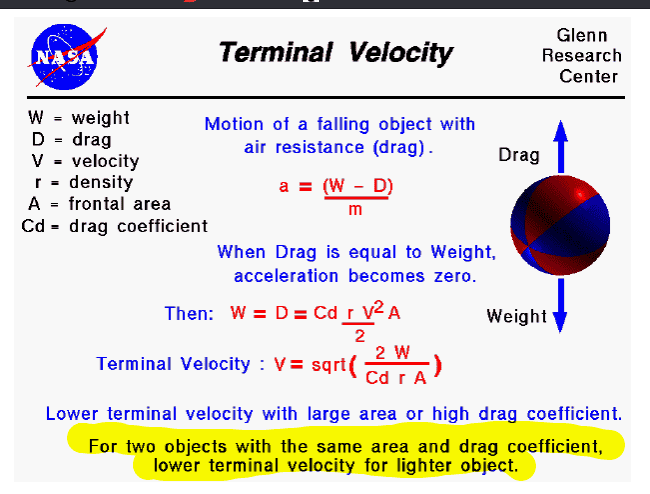

3. Describe how the mass of an object changes the terminal velocity of that object when falling.

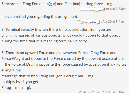

Teacher Comments
5 and 3 are incorrect
Teacher Clarification (Email)
My Response :
Teacher Further Response

On 3 you are incorrect correct. The terminal velocity ( asymptotically approached velocity for which ##\dot v =0## from Newtons Second) is inversely proportional to the mass or square root of it ##( F_D \propto v^2)##

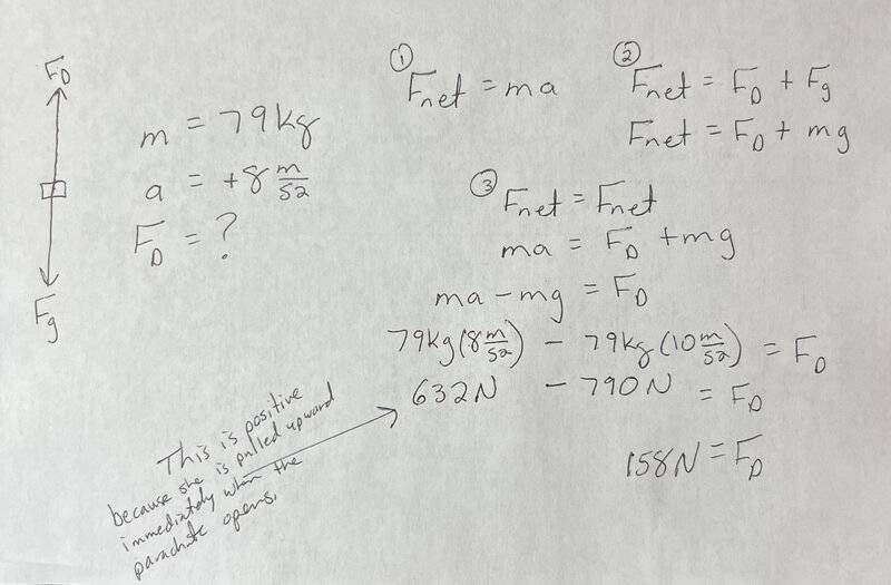

To put @kuruman's explanation in a form that might be closer to the teacher's thinking…
##ma=F_{net}=F_D+F_g##
is correct provided all forces and accelerations will be filled in using the same sign convention .
##F_g=mg ## implies the sign convention is positive down (since g is always taken as a magnitude, so positive).
With that convention, ##a=-8ms^{-2}##.
##F_D=-mg+ma=m(-10-8)ms^{-2}##.
But again, that is positive down, so the upward drag force is
##m(10+8)ms^{-2}##.
Moral: always state your sign conventions and check you have adhered to them.

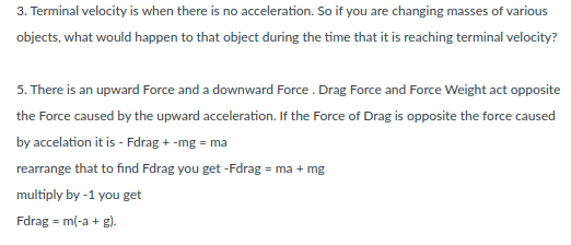

I think that adherence to the sign convention is not the teacher's problem here but unrecognized self-contradiction is.
Teacher says
"There is an upward Force and a downward Force."
Furthermore, the diagram in the teacher's email shows the drag and weight forces in opposite directions. This is all true and correct.
Then in the next sentence the teacher says
"Drag Force and Force Weight act opposite the Force caused by the upward acceleration."
Whatever the direction of this so called force caused by the upward acceleration, the second statement implicitly contradicts the first by asserting that drag and weight act opposite to this force, i.e. drag and weight act in the same direction.
The sign convention whether "up" is positive or negative never enters the picture.
