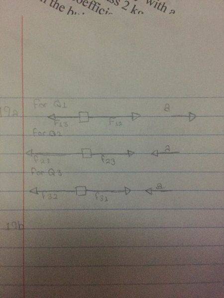

Ok sorry to add that I already drew the free body diagrams but after that I'm confused.

Next step is applying Coulomb's law to find the forces between particles. You can start for example, by computing ##F_{12}##. You need to know the charges ##Q_1## and ##Q_2##, as well as the distance between these two charges.
