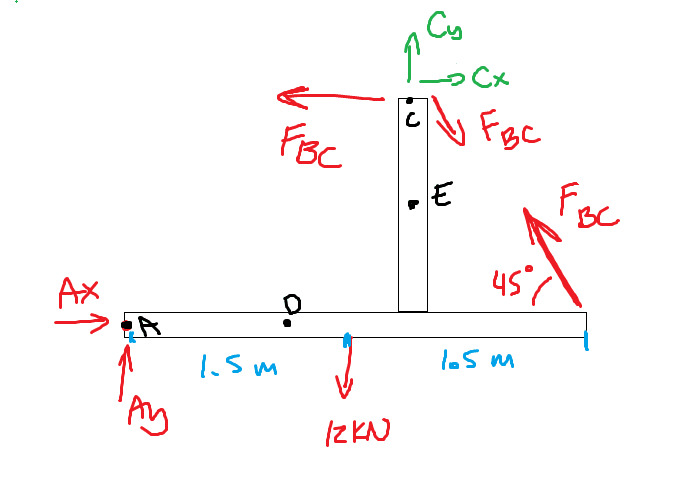

Attempting to draw the FBD for this problem but was wondering what to do about the cable, especially when I determine the internal loadings at E. At C, do I only draw one force arrow (CB), or draw both on the left and right side?
You draw ALL of the forces extant at that point. How many are there?

xxxyzzz said:
The cable passes over a smooth peg at C.
Welcome!
The cable, just like it happens to any rope or any chain, can only pull, it can't push anything.
In order to pull an object, it needs to be solidly attached to it.
Please, note that the problem states that the cable is not attached to the point C, it can only freely slide over it.

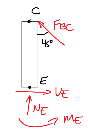

Hello, thank you for the welcome and responses. I am unsure if the notifications will be received if I do not click on the reply button, but I drew my idea of the FBD below and what I think all the forces are. I did not think that the cable is only pulling. Is this a correct assumption of the forces?
And to find the internal loadings at E, do I proceed with this?

I believe that the equivalent point load to the distributed one should not be 12 KN.
What Ve stands for?
Likes hutchphd
What Ve stands for?
My apologies, I screenshotted the problem from the textbook where w=3 kN/m, while my homework problem had w=4 kN/m. It should be 9 kN in my FBD. Ve is meant to be the internal shear force at E.
No apologies needed.
Force at C is incomplete.
If the structure is in equilibrium, the summation of forces and moment acting on each of its elements must be zero.
Draw the ENTIRE FBD all at one time with ALL of the forces. Always do that when solving this kind of problem

https://www.physicsforums.com/attachments/313781Are these all the forces? I did not think that C had any reaction forces because it is smooth.

I was editing my post since I was unsure about my diagram, which was probably why the link was broken (might have accidentally deleted it). I believe I forgot some basic concepts from Statics since it has been a while, so I am having trouble understanding what forces I am missing. I do not mean to make you feel like you are "pulling teeth." Would like to ask you to be patient with me. Here is the reupload.

Check your math on the distributed load. The reaction force at C, doesn’t exist.
Likes xxxyzzz
This diagram is much better.
Time to compare forces and moments to determine the value of the cable tension Fbc.
With that value on hand, a vectorial addition of the tensions (same value, different directions) acting on C should let you know what types and what magnitudes of loads the cross-section E of the vertical element is withstanding.
