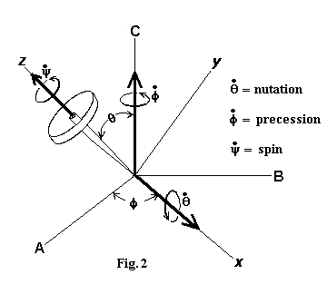

The initial query was raised specifically because of the stability aspect...if "the net effect of gyroscopic forces is dampen steering response", then doesn't hat mean it's more stable? EG a minor twitch whether from the wind or from steering input is minimised?
and as speeds increase the gyroscopic forces cause a bike to tend to hold a lean angle as opposed to straightening back to a vertical position.
That also seems to confirm my side of the debate...holding a lean angle means (to me anyway) that it's more stable...yes, it takes more force to bring upright (fighting against the gyroscopic forces) but as motorcyclists, that is true with or without a side wind...we compensate for it unconsciously with counter steering (I'd love to see the final equation for that!) and subconsciously shifting weight to the 'inside' footpeg etc.
I've looked at page after page of (to me) meaningless equations that I truly can't follow...I feel physics far more intuitively IYKWIM...this diagram makes total sense to me(even if I can't name the symbols :D)

For a bike, "stability" refers to the tendency to return to a vertical orienation if disturbed. The direction of travel may change, but a "stable" bike tends to remain or return to a vertical orientation. This could be called "positive stability". The tendency to hold a lean angle could be called "neutral stability" (no tendency to return to vertical orientation (no tendency to change lean angle)), and the tendency to fall inwards or outwards could be called "negative stability" or "unstable".

Personally I'm not convinced that gyroscopic forces are big enough to be significant for bike stability, though they do act in the right direction.
FWIW you can make a bike that is self stable without gyroscopic wheels and without steering camber.

When you have fast moving body, it is hard to change its direction by pushing it a side (with force perpendicular to its movement direction )
And it is harder when it moves faster (the angle between changed direction, and previous direction is smaller)
The same happens when you have a rotation.
When the wheel rotates fast, it is hard to change the direction of its axle
So it seems more stable (you need a great force(torque) to change the direction of its axle).
