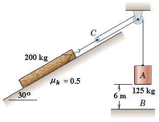

The 125kg concrete block A is released from rest in the position shown and pulls the 200kg log up the theta=30degrees ramp.
Case 1: if the coefficient of kinetic friction between the log and the ramp is Uk=0.5
(a) Find the magnitudes of velocity and acceleration of the block A as it hits the ground at B
Case 2: If it is changed to a log with 400kg, consider kinetic friction between the log and ramp Uk=0.5. Determine the value of the critical slope (theta), that if theta is larger than this value, the log will slip down when the concrete block A is released.
Case 3: If theta=30degrees and it is changed to a log of 400kg, determine the value of the friction coefficient (the critical friction coefficient) that would result in a zero acceleration of the block.

'pic' shows a diagram of the problem

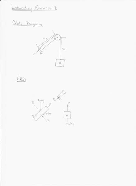

'001' shows my cable and FBD for how i have set up my equations

Case 1: I have achieved 2 equations as shown in 002
0.5(173.205)-2T+200sin30=(200/9.8)Ac
or 186.6025-2T=(200/9.8)Ac
and 125-T=(125/9.8)Aa
I currently have 2 equations with 3 unknowns, and don't quite know how to approach that.
For Case 1, I simply have to work out those 3 variables and then find velocity of Block A using Aa and fall distance, but really need a little assistance working out those set of equations.

I also found the third equation to use as 0=2Aa+2Ac.
Using this I found T, and substituted it into find Aa and Ac.
However, by this method Aa and Ac and equal with opposite signs (as I should have predicted from the above formula). This is incorrect, so I'm stumped again.
